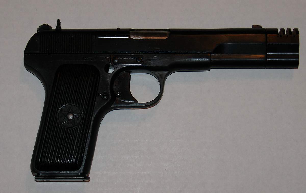

I have a muzzle brake on one of my Tok's, and it works well. The pop-up is noticebly reduced, and the recoil feels straight back. It's this style:
Thanks.. I'd love to own a "tetka" (one of Eastern European nicknames for the TT, means "aunt" lol) but I remember it having more recoil than the 9's and 40's I've shot and with my current shooting mad skillz, the less recoil to distract me, the better :cool:
