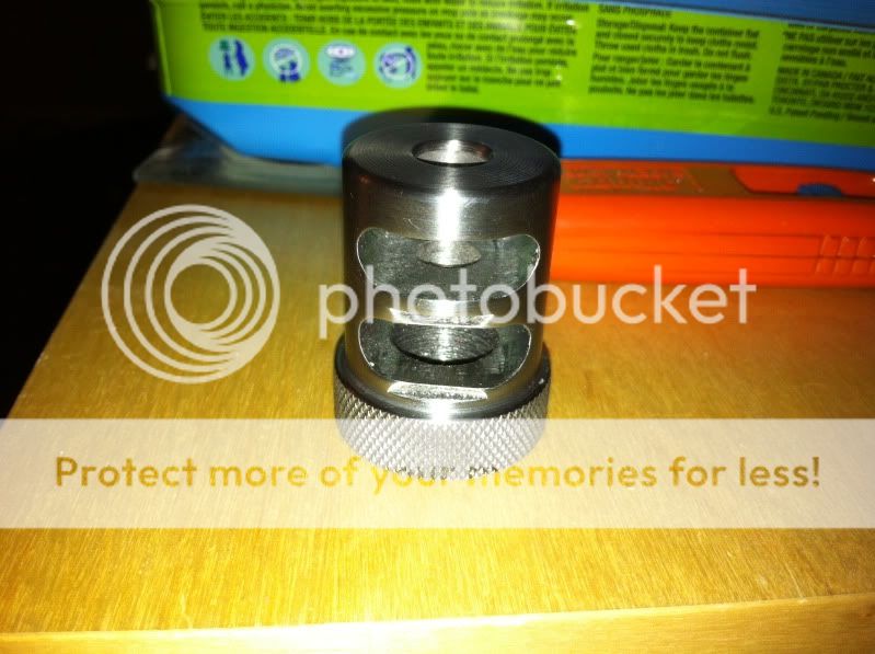

I test 2of these short one and it work really well, 300WM less recoil than my 243win heavy barrel.
diamber range from 1.25 to 1.5", length:less than 2" long.
but if you want maximum recoil with magnum caliber, but willing to take a risk of being deft , than these one will do.

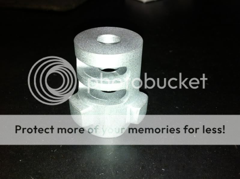

diameter: 1.5 Length:2.6" long.
Very tiny and yet it effective, Look with wing nut but it adaptor connector.

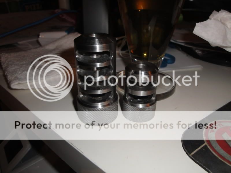

1" diameter and 1.2" long.

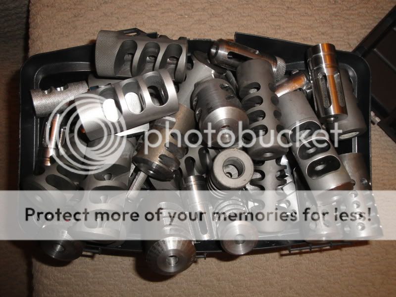

Have you tried everything in this photo? Do you have favorits, or performance comments on each style?
I have try most of them on 308 and 300 wm, some on 338, and the result have amaze and supprise, some doesn't work as well as the other, which require some tweak to maximize performance.
I am very happy with the outcome and result.

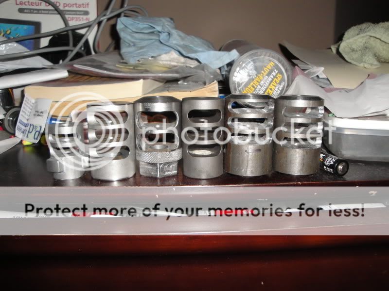

ok silly to ask but could this be shorter and work? like cut off the last port?
For best performance, minimum is 2 port per side, unless you make the exit hole with smaller clearance, and extended the baffle to a larger side, also the angle of the port does have a big effect on recoil.
