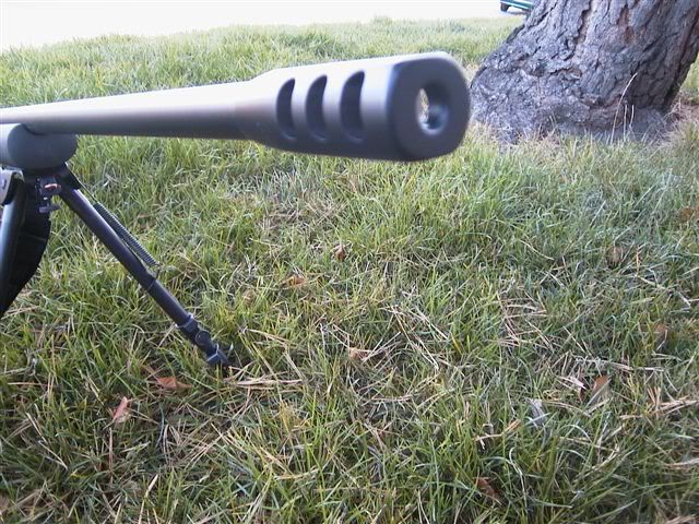

This is the brake knockknock is talking about.Just found out how to post pic,Getting carried away.LOL
