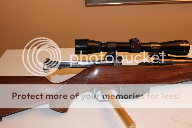

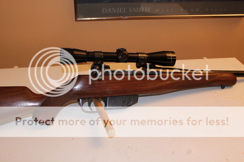

So I acquired a Ross Model 1910 rifle a while ago. It had been nicely sporterized [new stock, scope mounts built, etc.]
Problem was, the original barrel had been treated to many rounds of corrosive 303 ammo, and probably neglected.
After an extensive scrubbing, I shot it and the best it would do was around 3½ - 4 moa.
So I contacted Jerry Teo, [Mystic Precision] who had McGowen make me up a C-M barrel blank in the original contour.
I have just received notice from my 'smith that the project is completed. I should have it next week. I'm a bit excited
to see how this new, .311 tube will perform.

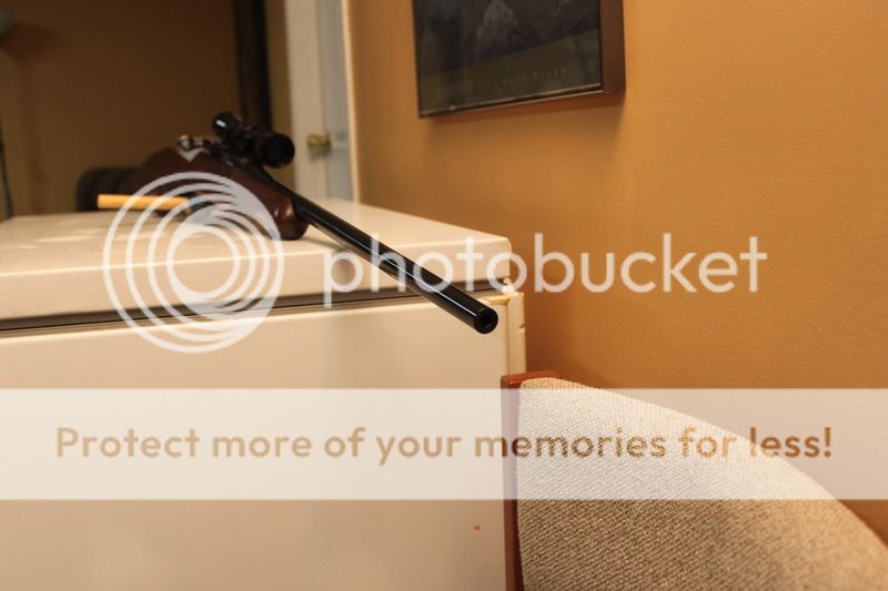

Pictures added below. [6x36 Leupold on top.] And, yes, that is a solid brass buttplate with a trapdoor in it. :)
A full report later. Dave.
The barrel was just north of $400.00 in Chrome-moly. Contouring to the original pattern is why the higher price.
Then the Smithing. These have a complex breech system, and require some attention to detail.
Then I had it all re-blued as well. All in, around $1200.00. Sounds pricey for an older rig, but the Ross rifles
are unique, and form a part of Canadian history. I want to hunt it and take a moose or deer with it.
Cheers, Dave.

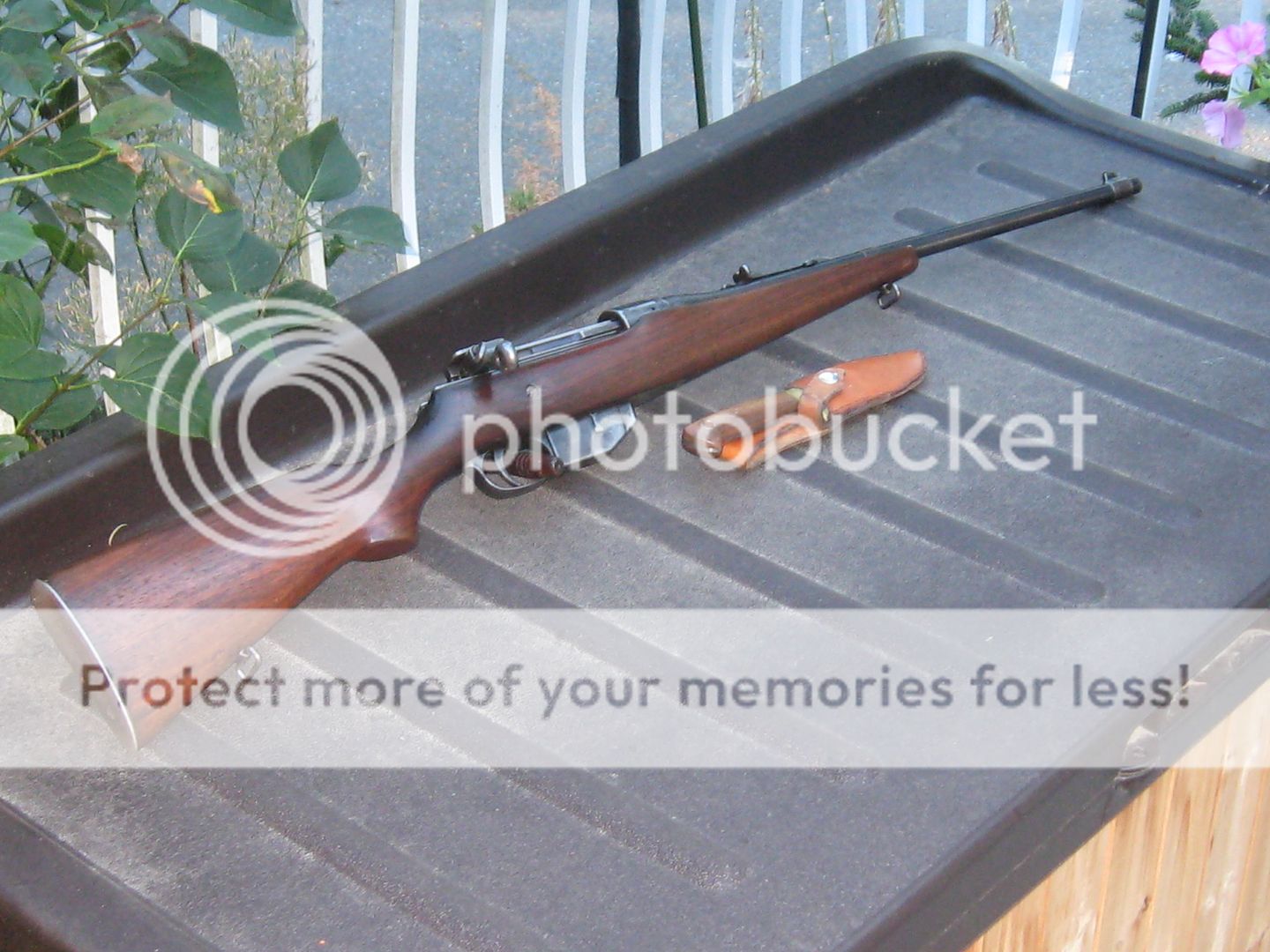

Heres mine, all original sporter.

Ross Rifles = Sweet spotters!
Here's my factory .280 with Lyman Alaskan. There is well over $1200 tied up in this one.
Kevan:
You might be amused to know that you have a factory sporter and it is an R-10 so called.
Square sling swivels and Winchester rear sight are a dead giveaway.
Have the same animal myself.
If it has a serial number on the barrel on the port side just ahead of the action you may be certain it is an R-10.
Have a look and let us know so that we may get it in the data base.
Good luck
Oldguncrank
