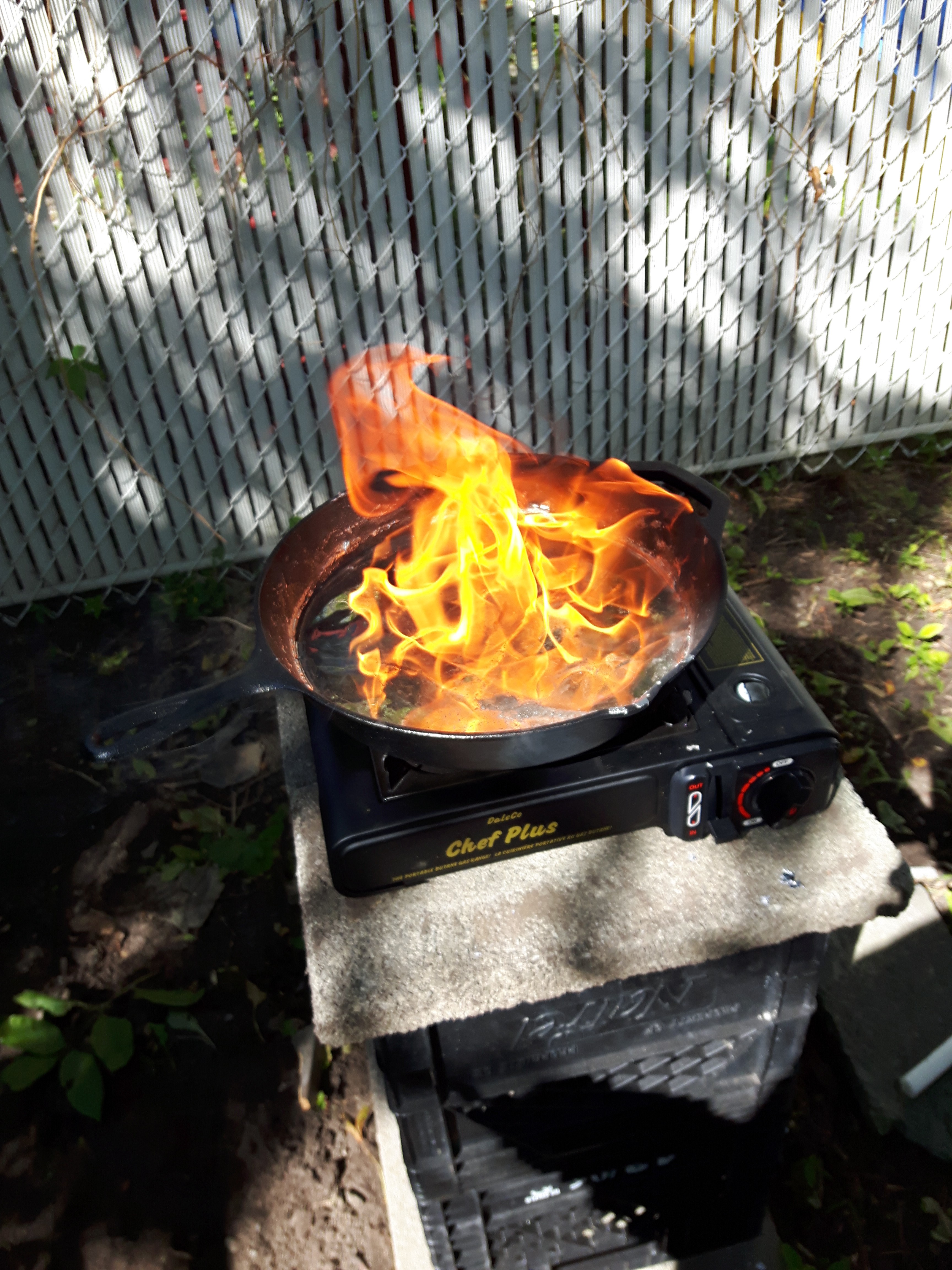

Hey guys. Did my 1st ingots today. This was basicaly a trial run to see if I was comfortable with the process and ended up with 10lbs of mini muffin ingots. The only problem I encountered was that I had to keep stirring the lead or else it would solidify on the edges of my too large pan. I'll either change the pan to a smaller one or get a more powerful camp stove for the next time.

personally, I would want something a lot more stable than that setup. It wouldn't take much of a bump to spill a pan full of melted lead onto you
I see your concern but I flattened the ground, put 2 concrete slabs at the bottom and 2 at the top of of the milk crates. I tested the stability by putting my weight on it and nothing moved. I would have set up another way if I did not have those slabs.
I'm very conscious of the dangers involved in melting lead so I move around keeping that in mind ☺

Did you flux the lead at all to remove the impurities? I'd do that before making the ingots, that way you have it done and can just melt the ingots to cast when you're ready. I've only been melting and casting ingots so far, no actual bullets, but I've learned a lot in the past bit, and now have a nice stash of 60 lbs of pure lead ingots waiting for casting time.
You can see on the 3rd pic I posted when I fluxed. I used some wax from a candle. Can't wait to do another batch and accumulate a stash like you.
