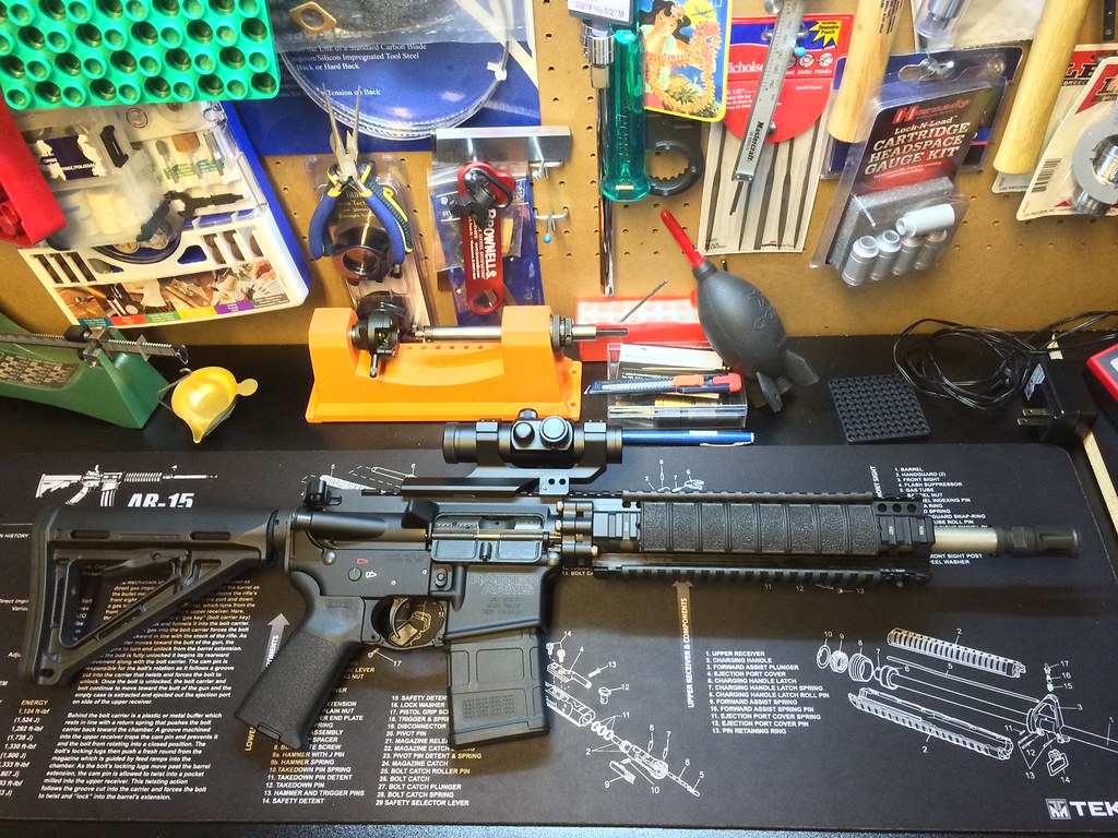

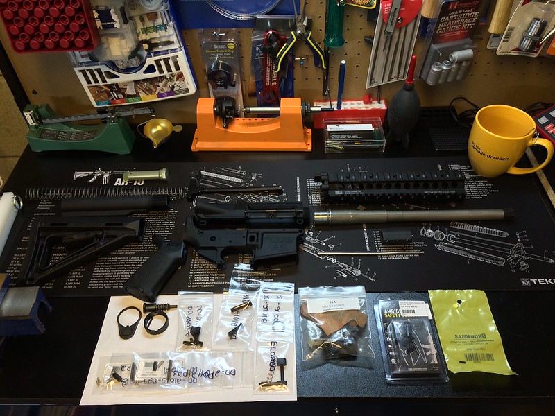

Yup. Uses 300AAC Blackout ammo (SAAMI standard and not a wildcat cartridge anymore) with the same 223 mags, BCG etc. Only diff is the ammo and barrel.
nice build! (exept for the NEA bbl but you've got a DD on the way so...)

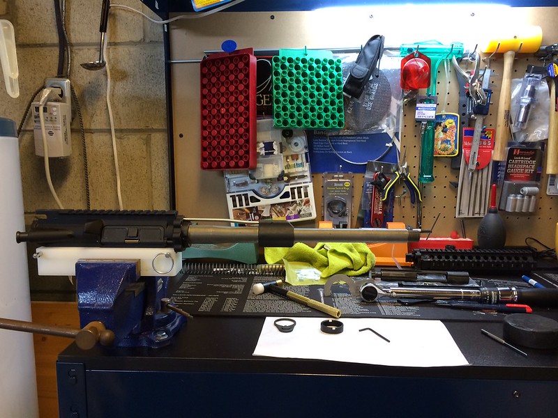

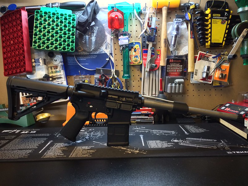

Yeah, I got this barrel 'cause there was nothing around shy of the $350 mark. I was getting desperate and contacted a sponsor but they never replied back so I went with the NEA for now. Just waiting for the 10.3" DD barrel from Wolverine to come in 'cause I originally wanted a 10.5-11.5" barrel. I've heard good things about NEA barrels so we'll see. :)
