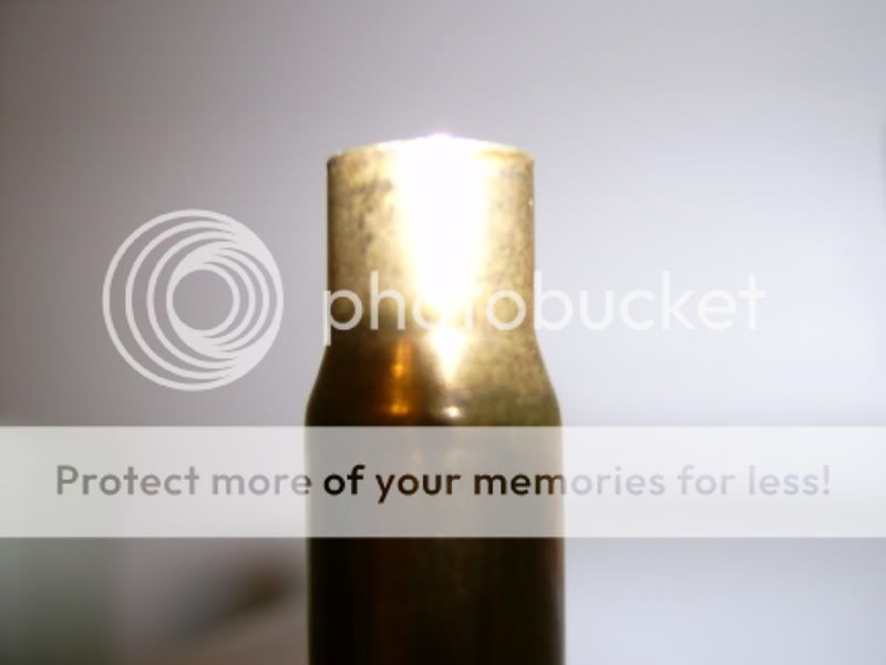

I just necked up my very first cartridge case. I necked up a Winchester .308 case using an RCBS FL .338 Federal die. I'm surprised how easily the neck expanded, however I noticed it's not quite perfect.
On the left side of the case pictured, you will see the slightest 'bump' where the neck meets the shoulder. I tried it in my rifle, and it chambers. I belive this will fire form when it is shot, but am I doing somthing wrong here? It's only very slight. Will this cause me problems, or shall I resize the whole batch like this and not worry about it? Thanks.
I have had better luck using a Lyman M die when expanding necks and I only use the M die when full length sizing any of my reloads, I do not use the expander in the sizing die. It adds a step but I seem to get less case stretch.
They will fire form but I would size them all first and them load them.
You may want to check them for length as well.
Let us know how you make out.

Also, my reloading info states my measurments should read 1.675 inches from the bottom of the case to the base of the neck, but my die is giving me a measurment of 1.688, a little longer, but again, it chambers. Big deal?
I'd trim them to the proper length. They may chamber as is, but you don't want them too long.
No that didn't come out right. My case overal length is shorter than the maximum. The longer I was refering to is the distance from the base to the case neck base.
The body length difference is not a problem. As you said, it chambers.
When I neck .30-06 brass up to .35 Whelen, the newly formed cases are always shorter than when the original .30-06 length.
