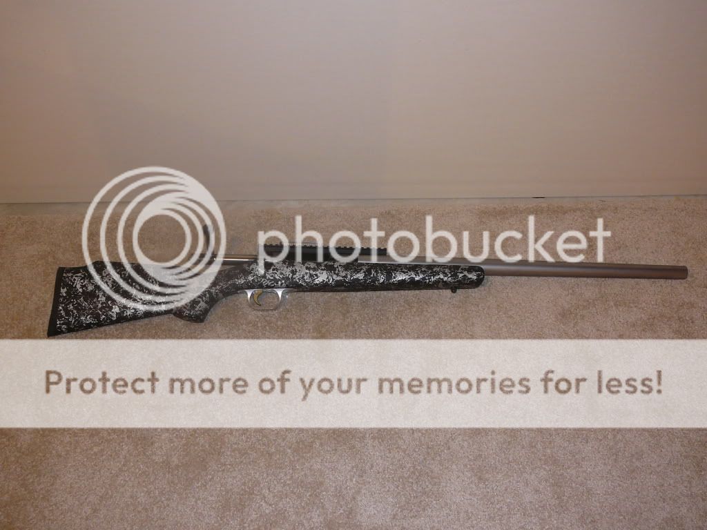

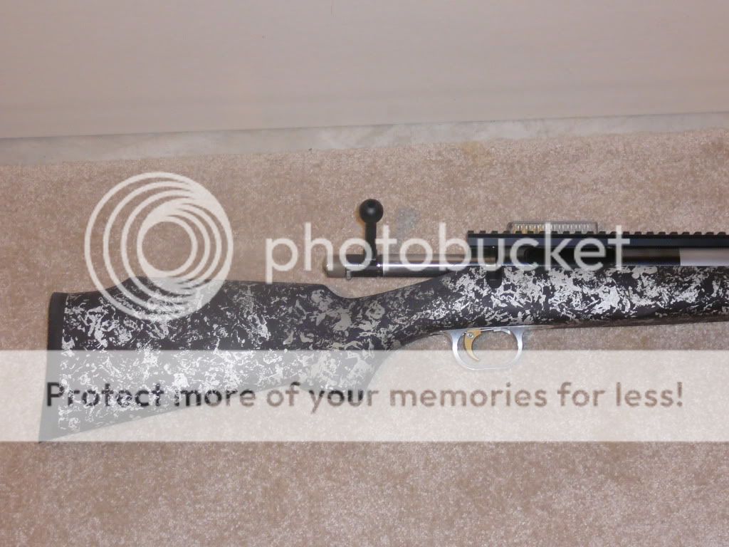

Just excited to share a pic of my 6mmBR:D - always enjoy seeing what other people have done, so I thought I would share
It is: a Barnard S action, Robertson Composites Predator stock, Krieger 17A barrel (1 in 13.5"), CG trigger. Gun smithing was done by Mick McPhee
Now I haven't decided on the scope yet....
Can't wait to get out and see how it shoots - just a little busy with the Christmas thing right now
cheers,
Mark
http://i288.photobucket.com/albums/ll165/mklages/P1030826.jpg
http://i288.photobucket.com/albums/ll165/mklages/P1030827.jpg

Fixed it for ya. :)
Mark, That is AWESOME! That will make a killer varmint gun!!!! Donp here uses a light 6BR and the accuracy and velocity are incredible. Two essential qualities of a varmint rifle.
It will also put a smile on your face should you decide to pursue short(er) range target shooting. It is nice to see pictures of a true purpose-built precision rifle!
I didn't paint the stock - I came that way. If you ever order a stock from Robertson Composites, they can do just about any colour or combination of.
The intent was to shoot bullets between 60-70 gr. I've got some 60 and 66 gr bergers to try out right now and will likely try some V-MAX's as well.

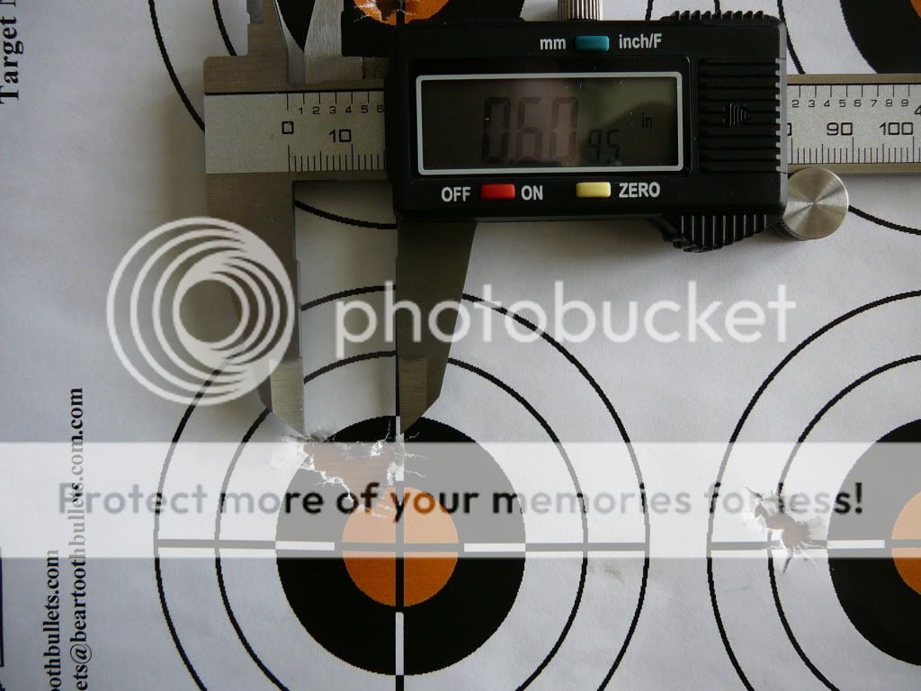

Best Target for 1st trip to range
It was a little chilly here in yesterday, but I just had to go out and get a few rounds down the barrel to see how it was...............it still makes my smile thinking about it.
I think I've got the outside edges...........so 0.6095" minus 6 mm = one freakin' happy camper :D
That was 65 gr Bergers with 32.5 gr of Varget lit by CCI BR4 primers (5 shot group). And yes that is the BEST group of the day , the other's weren't as good but hey.....did you see that one (makes you forget about the other ones)
Hot damn that gun shoots good.......imagine if there was someone skilled behind the trigger :rolleyes:
