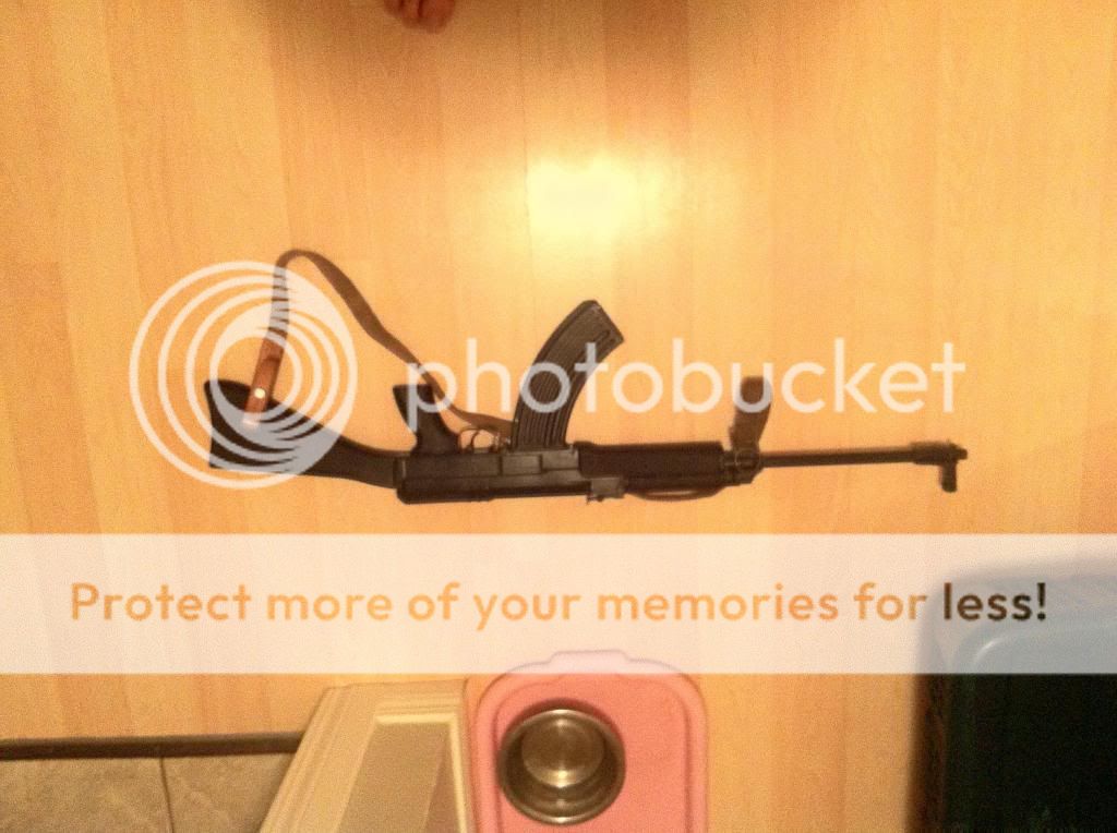

This is what it looked like stock
Although this is a cz 858 with all the black furniture of the vz it gives you the same idea

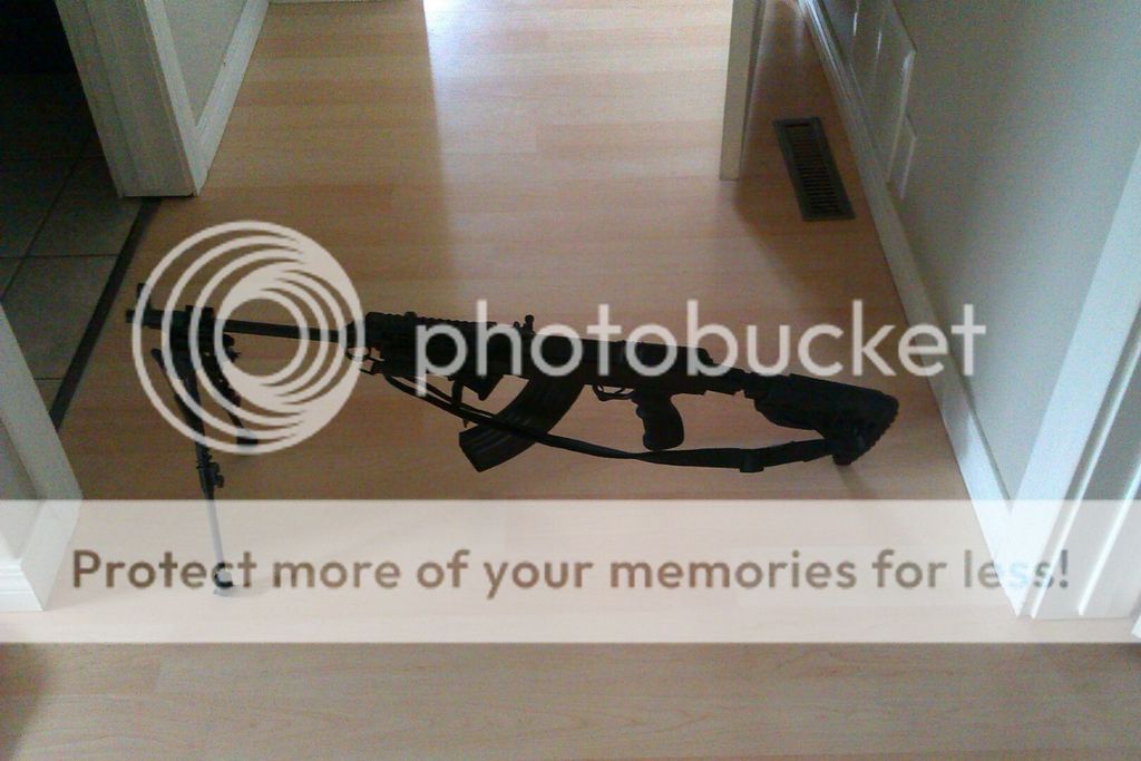

This is the after
No scope was mounted in this picture because i was not sure how i was
Going to install the side rail. The bipod is now off as it is useless for what i was doing
I might reinstall it for my coyote stands

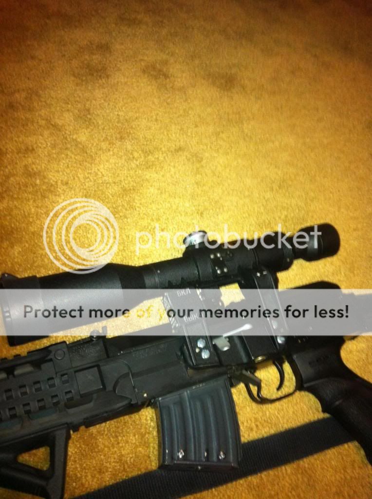

This is the scope i bought for about 325 dollars
It is a posp 3x9x42
Okay now this is not the right scope for this caliber, this scope is calibrated for the 7.62x54r round
It has a 1000 m range finder and compensates for bullet drop of that round.
Not that any of that matters, due to the great customer service at eastwave i was lead to
Believe it was a 7.62x39 reticle. Horrible customer service. But it's the only place to buy posp
From and they have a awesome impressive selection of scopes. I would rather support a local
Company like interammo but I'm not sure if they have any products.

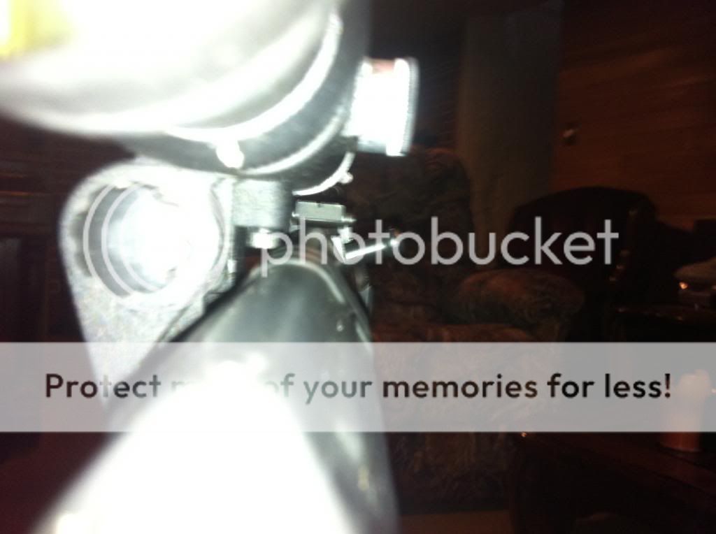

Bad picture, but I'm still able to use my iron sights, this is very effective for close range quick on the run shots
Very good for coyote hunting, i don't have a shell deflector yet, this is a problem with the open bolt as shells
Are hitting my scope although it doesn't throw the zero off . I'm building a deflector and pretty sure it will
Interfer with viewing my iron sights

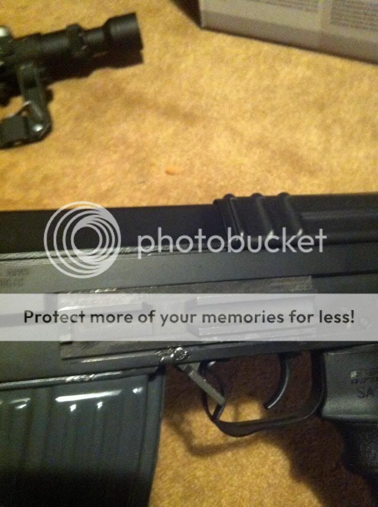

Installing rails... I've done the drill and tap thing.. what a process. The receiver walls are to thin
You make it work with a spacer. But honestly what a waste of life. My way is way better
I installed it using a very eexpensive epoxy, i wasted A LOT time searching for rails and trying different things
This is the way to do it without drilling holes in your rifle, this is gun let alone rail has been put through
Abusive amounts of durability tests and hasit come off. The rail is from ebay for 8 dollars eastwave has them there are three different types
Of rails a,b and c i spent some time trying to figure out wwhich one i needed, to avoid this ask about it when u buy the scope

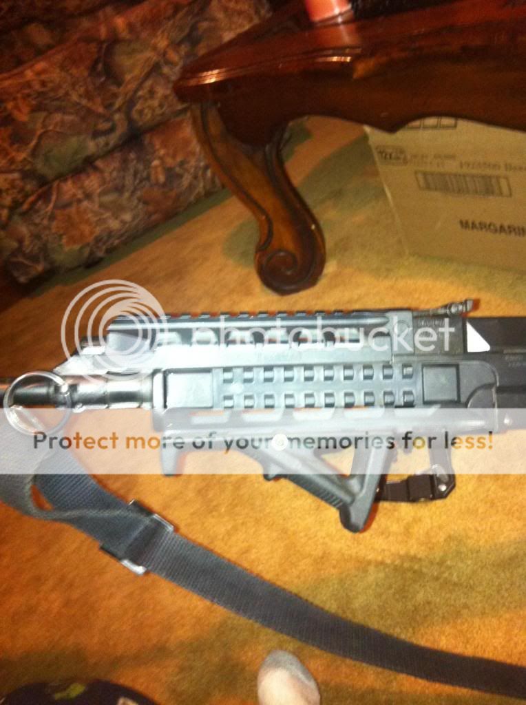

This is a bc tactical gen 1 vented handguard, underneath is a magpul angle grip
This was a very hard choice ,it was this or the NEA but i didn't like the top cover on the topNEA plus i knew i would
Never mount anything to co witness the iron sights. Fab defense has a couple of nice handguards to but
One is plastic i just couldn't trust that around the barrel and piston it get so hot in there, and the aluminum one they
Have is really nice but it covers the gas block, i don't like that i think the gas block gives it a classic ak look which i love
So i got this one for 200 dollars, it's vented so keeps it surprising cool under heavy fire and looks very nice as u can
See you nice shiny piston inside.

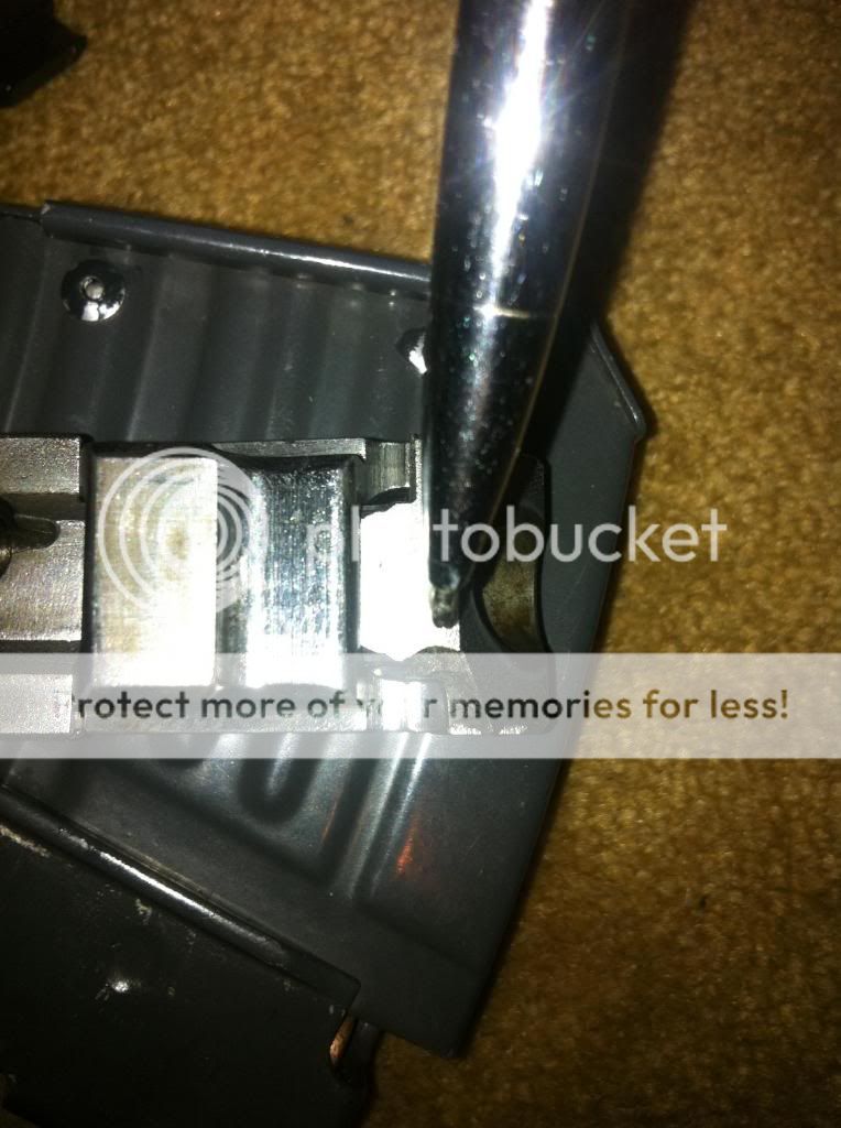

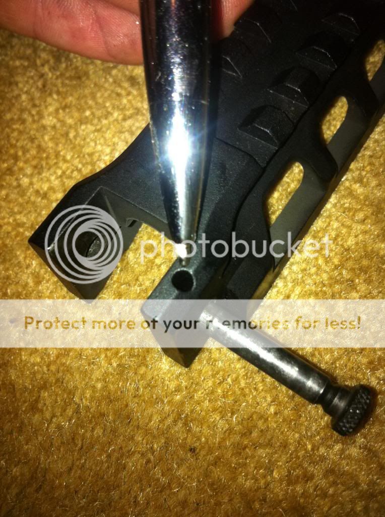

This is tricky, to get this pin out requires a paper clip straightened out with a little curve on the end
You have to stick it that little hole
and depress a little pointed pin on the a spring.
Anyone has a better way please post

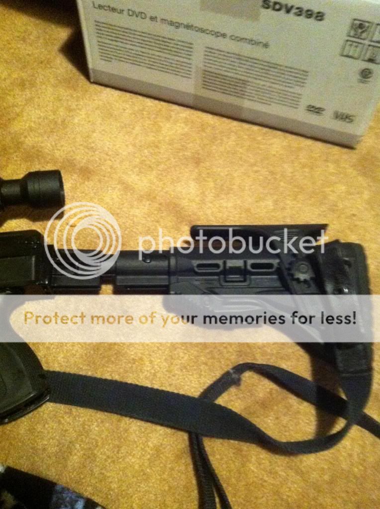

Fab defence stock and buffer tube
Wow this was hard to install, a lot of colourful language used with the install

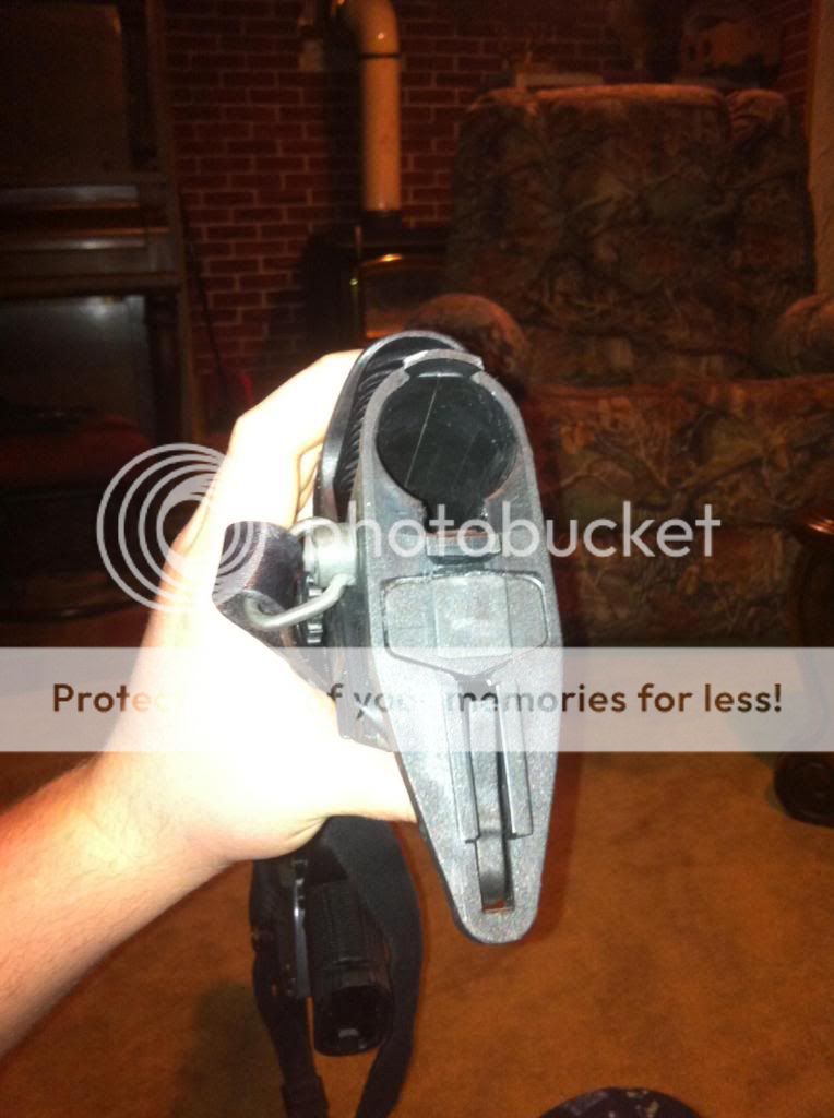

This is the stock i picked, and i love it. Some people don't and don't understand why. It's from wolverine supplies
I had to buy the buffer tube separate altogether was about 150 dollars, the buffer tube absorbs recoil and does a perfect job
The butt is adjustable on the tube i have it extended all the way all the time gives perfect eye relief tone adjustable cheek piece works very well with the posp set up to. If you noticed this stock angles down a bit while some stocks go straight back
Like NEA tube adapter in my opinion that looks horrible so i picked this and couldn't be happier, also has a cool storage compartment for batteries of extra shells i use my for a piece of paper with all my scope settings(I i have to switch elevation settings for different distances since eastwave was to lazy to sell me the right scope)

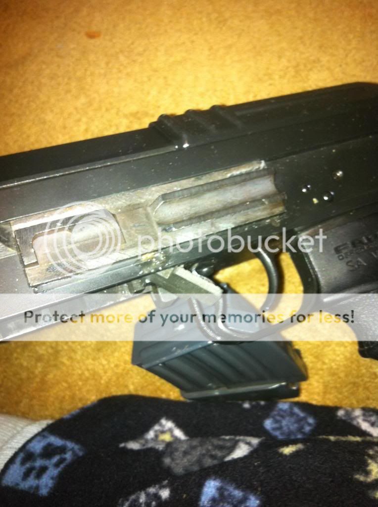

And this happened
One of the corners of the bolt broke off where it connects to the locking piece
