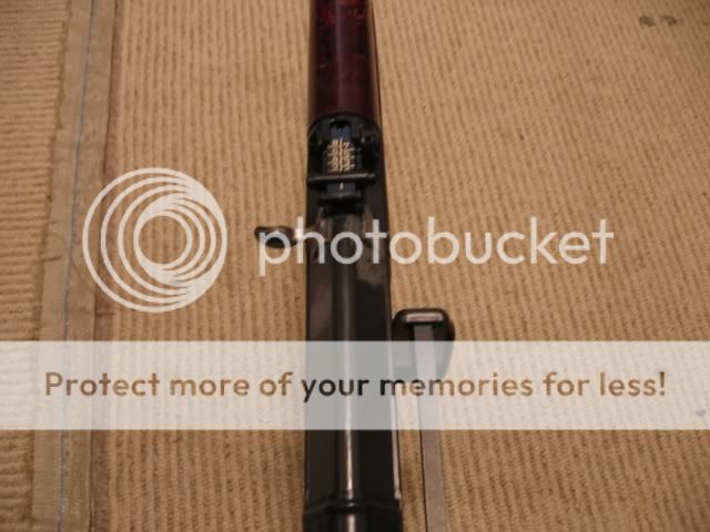

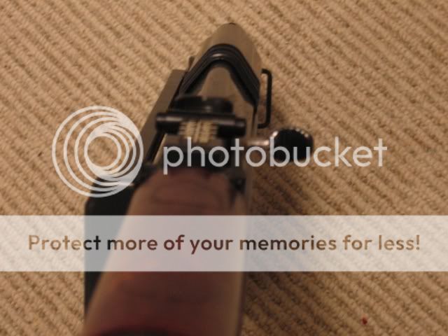

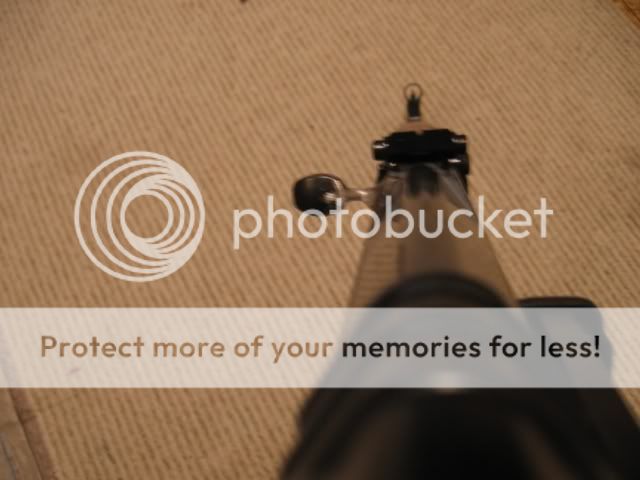

I had planned on doing this for some time, but I see someone beat me to it a little while ago. Anyway, here's my version.
Codey said:
Thanks, it's off a Remington 1100.
so tell us the process of removing the old handle and putting in the new, what kind of a weld did you do? i presume you will paint it.
I guess now he doesn't need to rotate his gun and reach over the top to work the bolt with his left hand.
I like the original location because it keeps the left side flat with nothing to poke or snag when the rifle is slung.
However I can also appreciate the need to customize a gun to suit it's owner! :dancingbanana:
I wish I had the skills to pull of what Codey has done!
:rockOn:
Can-down explained it well. I did this because I really didn't like having to tilt the gun and reach over the top to work a right side cocking handle with my left hand, it seemed unnecessarily clumsy and awkward. I find this setup easier, faster and it feels much more natural. Very soon I'm going to paint the entire rifle in black Armacoat.
As to how I did it, first I bought a new bolt carrier from Gun Broker in case I screwed mine up beyond repair. Then I drilled a small fairly shallow hole in the carrier where I wanted the new handle. Then I narrowed the portion of the handle that would be in the hole to the hole's diameter. After a little fitting and cutting to get the length and angle I wanted, I fired up the MIG welder and tacked it. Happy with the handles placement I welded the whole thing up. I cleaned it up and shaped it with a die grinder and an assortment of carbide cutters and sanding drums. After the new handle was in place, I cut the old one off with a hacksaw and grinded the area smooth.
