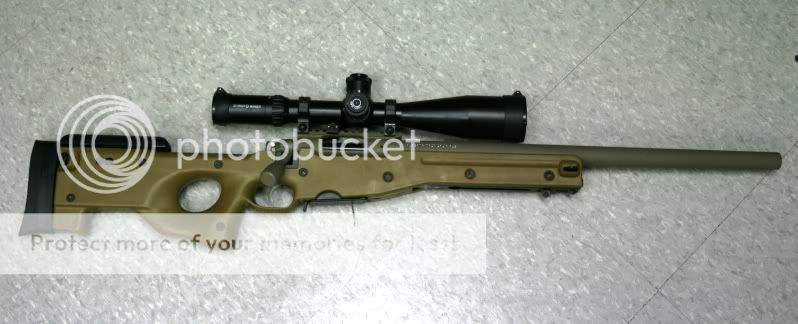

I stopped off at ATRS today and dropped off my Rem 700 stainless short action and my AI chassis. This is what We/I (Rick and I) decided on: Remington 700 stainless s/a
AI chassis system with FDE skins
22" Rock Creek barrel chambered in 308 with a M40 contour and a 1-11.27" twist
Jewel trigger
ATRS 20 moa base and TPS rings
Barrel and action finished with cerakote in FDE
An oversize recoil lug
and a ATRS bolt knob
Thanks for your time Rick and I will see you in a bit when I come to pick it up. Rod
Jewel trigger
