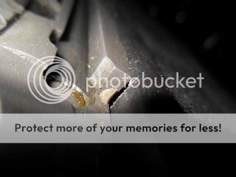

First this is my usgi stock that will be going to get repaired later becaused its cracked in many places.

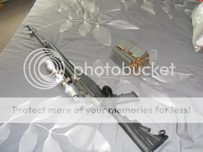

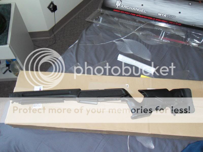

The promag unit

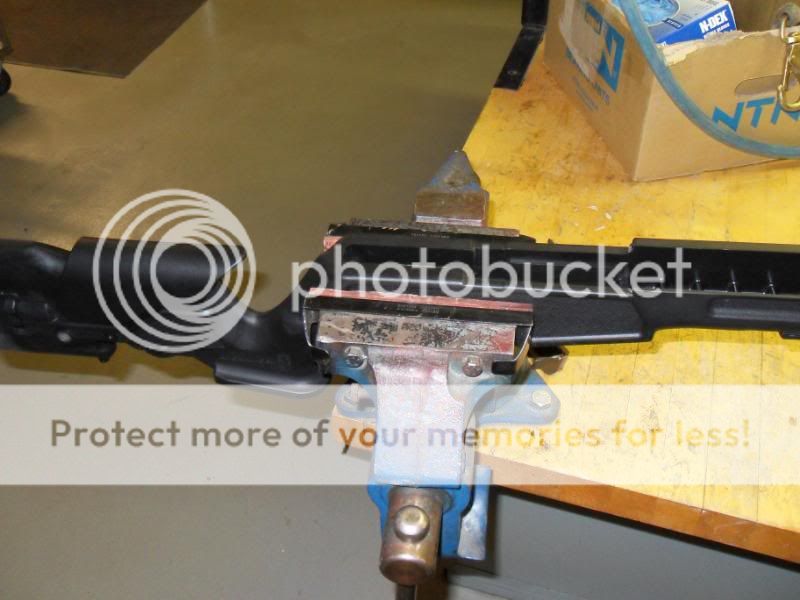

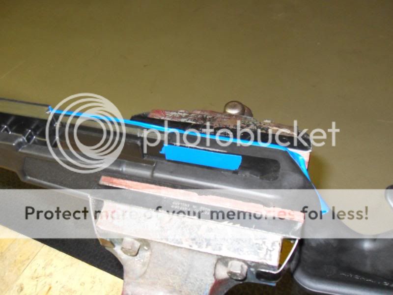

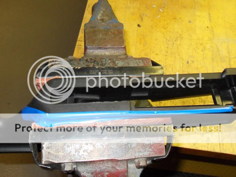

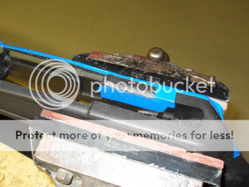

Now the mod secure the stock in a vise or anything you want be carefull to not scratch it.

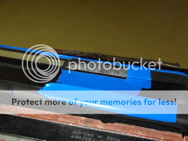

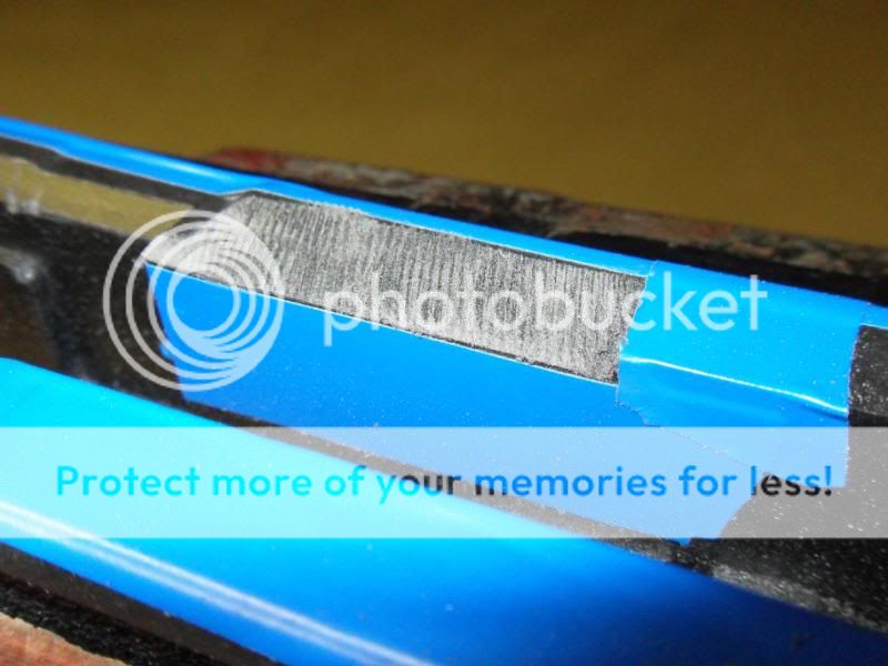

Then i protected the surrounding area with tape.

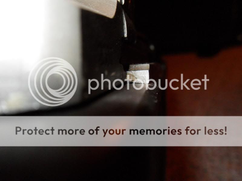

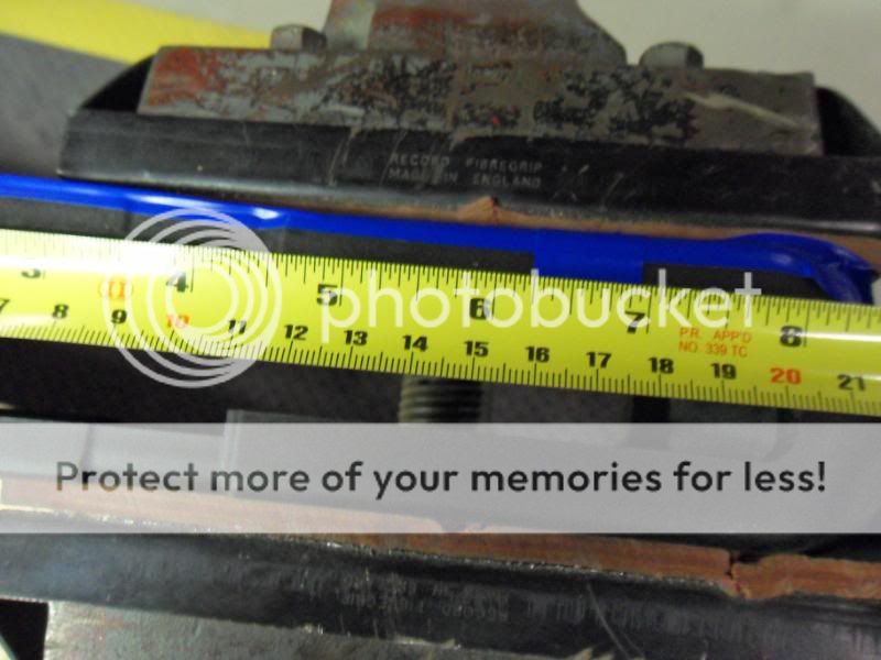

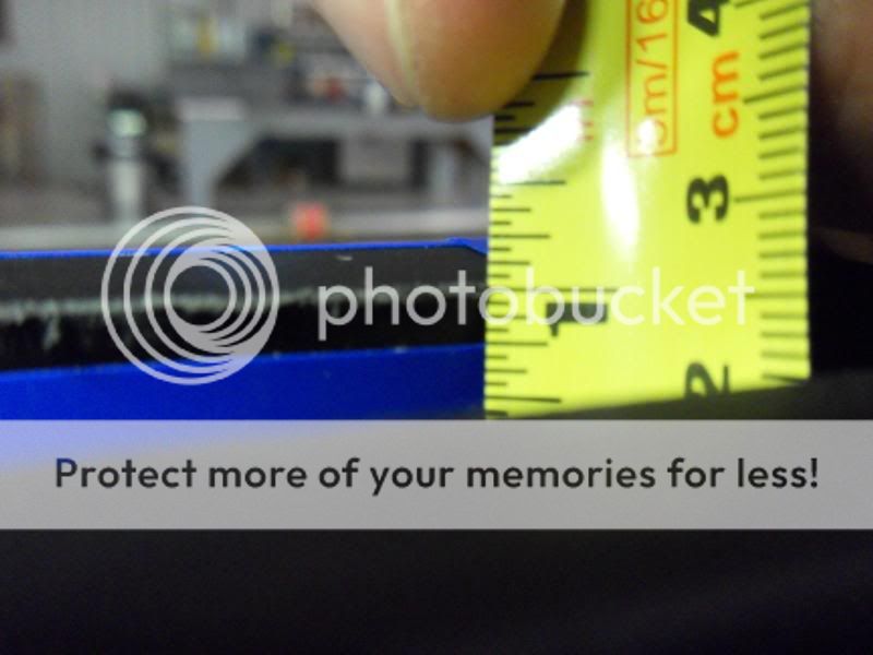

Then took some measurments as stated in other threads about this its 6" 1/4 long . I decided to file down only the remaning bit thatis about 1" 1/2 long. I had marks before measuing when i trial fited it before.
I measured about 1/8 deep that needs to be taken out. It can be less on your M14.

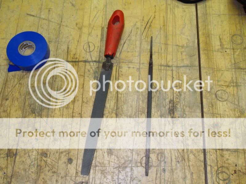

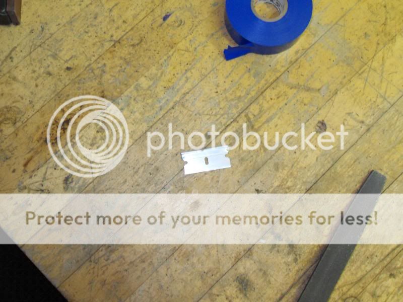

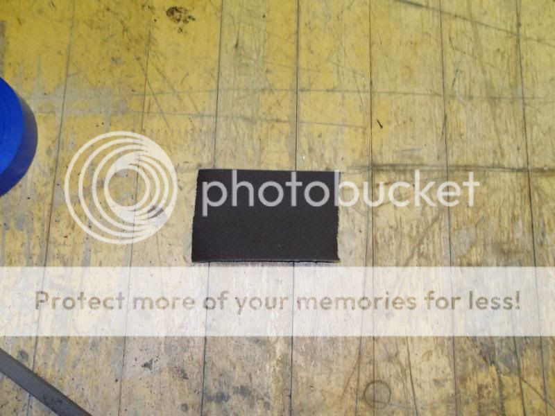

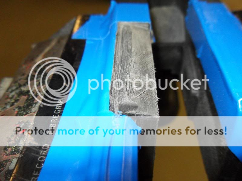

Then the tools i used 2 diffrent files and a razor blade to cut of excess and 180 and 320 grit sand paper.
Then start filling. BTW I messed it up a little as i started to make the "angle" in the wrong direction. In the end it didnt change anything, but i had to remake the slop here are the diffrent steps while i was cutting away.

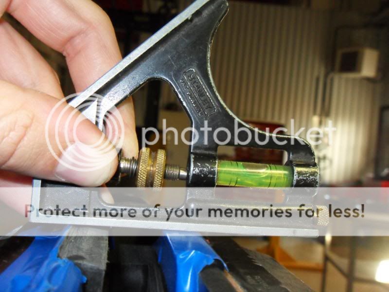

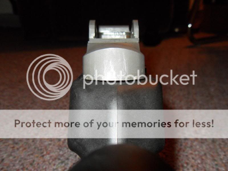

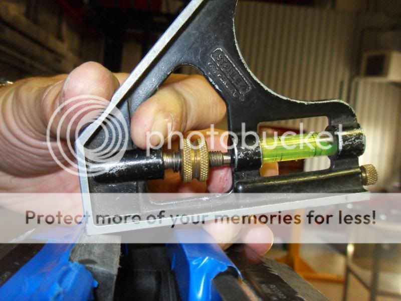

Lastly some pictures with a level to show the angle because it was hard to see on the pictures. Enjoy

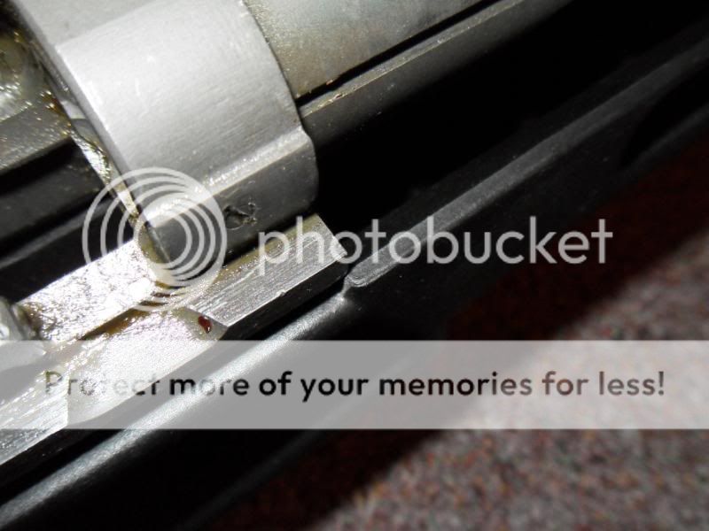

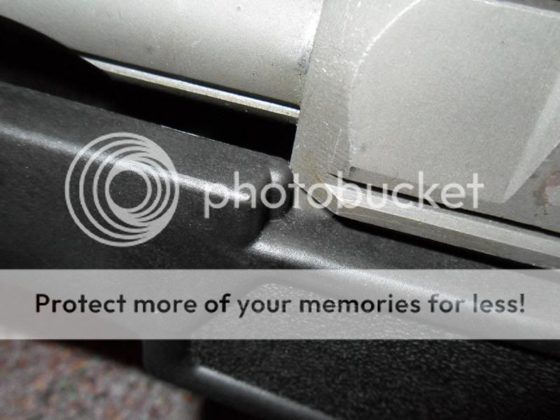

When i got home i fitted it in and their was some areas that needed filling more. Picture time !
Then i shaved the trigger fitting pads as per instructions no pics sorry. Then the trigger group went in pushed very hard and it locked. I flipped the gun over to check clearence and as you can see on the pictures it was still rubbing a little i used a razor blade to outline the excess then ill go file it down again tomorow. On one picture you can see its not sitting right its angled to the left.
