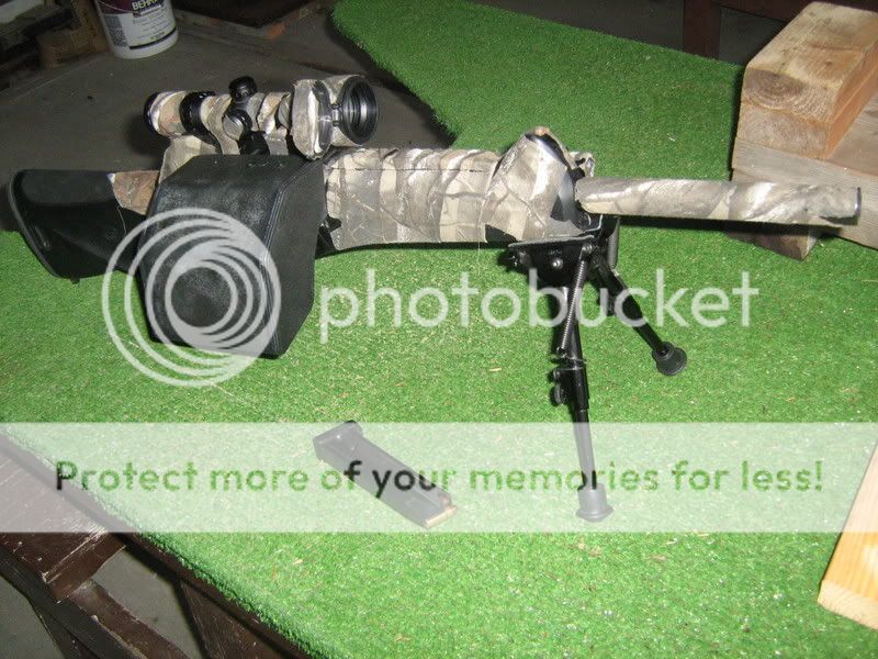

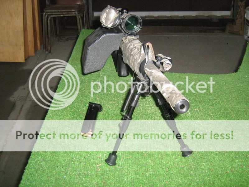

I finally did it. Bought reamer, brass, bullets, reloading dies and reamed-out my 9mm barrel into 357 SIG. It only took 60$ for the reamer and 15 minutes in a lathe to cut new chamber in 9mm Luger barrel. Well, I have another Beretta Storm in 40 SW that will eventually (Barry do you hear me?) become 7.62x25. So, I borrowed bolt from 40 SW to make my 9mm shoot 357SIG.
First shot and I really sorry for my old beat up Beretta, my old workhorse ain't gonna die in bed of old age. Noise level and recoil makes me think 147grain bullet is actually flying at some 1600fps or more. Shooting chrony refused to work today, it is a brand new piece and I just unwrapped it on the range and it is getting dark fast. So I guess I shall give you guys actual numbers later, once I find whats wrong with chrony.
lots of noise, accuracy went back to 2" @ 50 yards and there is some recoil at last. I think 357SIG is the end of the road for Beretta Storm, its polymer frame is getting hard pounding now. I don't think I want to hot rod 357SIG, published loads are good enough to make me worry about old girl.
For now I only tried 147grainers over 13 grains of H110, 124grainers over 14gr of H110 and 90 grainers (by far the softest load of these three) over 7.5gr or Universal. 124 grainers are still climbing at 100 yards and give about 5" groups. Well, I may be flinching and will have to verify later. 147 grainers are somewhere 3-4" at 100. I miss my 9mm Luger so much now. Factory-loaded 147 grainers (HP or TMJ's) in 9mm Luger were consistently 1.5" @ 100 and were flying at 1250 fps.
