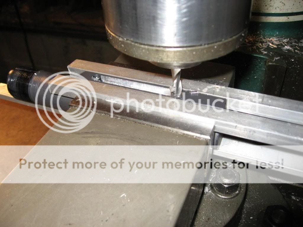

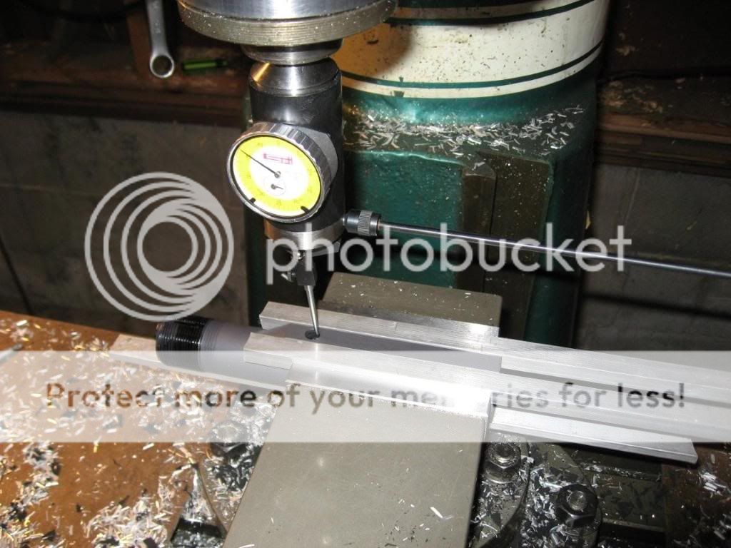

I trammed my mill, then centered on the hole in the tube.

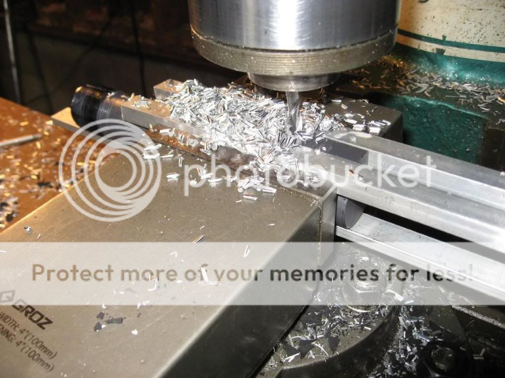

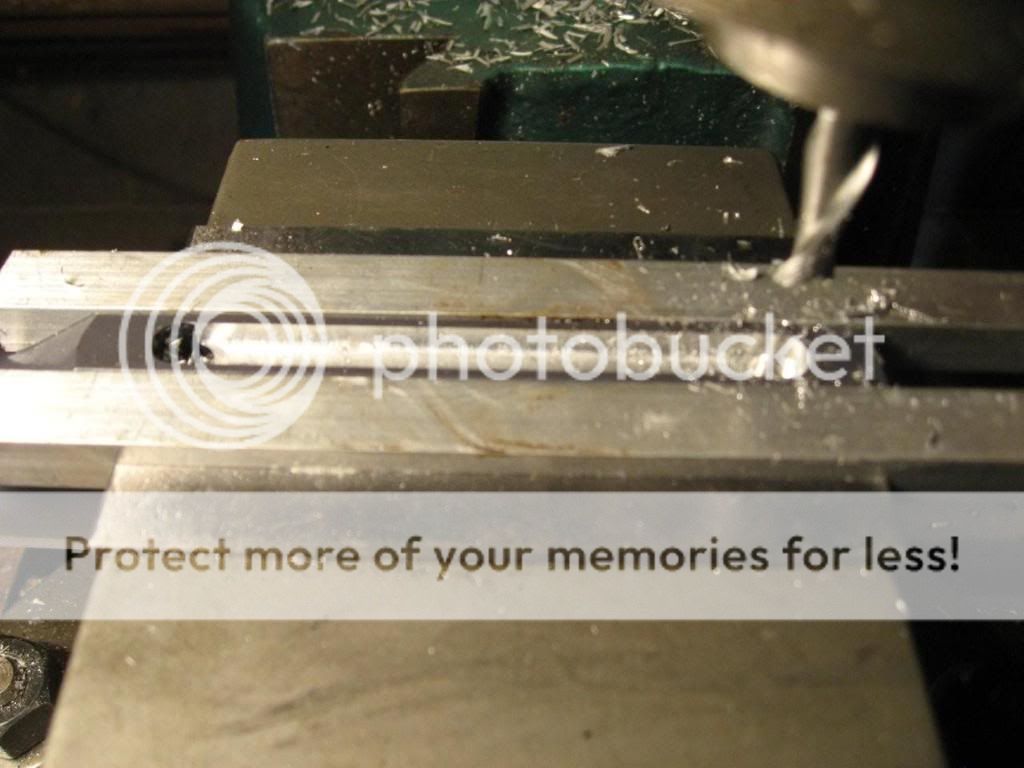

I took my measurements from a spare tube I just bought of the EE (thanks diver488 ). I plunged the end mill down .150 and then milled the slot. here are 2 pics, one had the slot covered in chips... the next one I cleaned it off. ;)
The completed slot.
I thought I would mill 7 holes... (hey, the price is the same) ;)

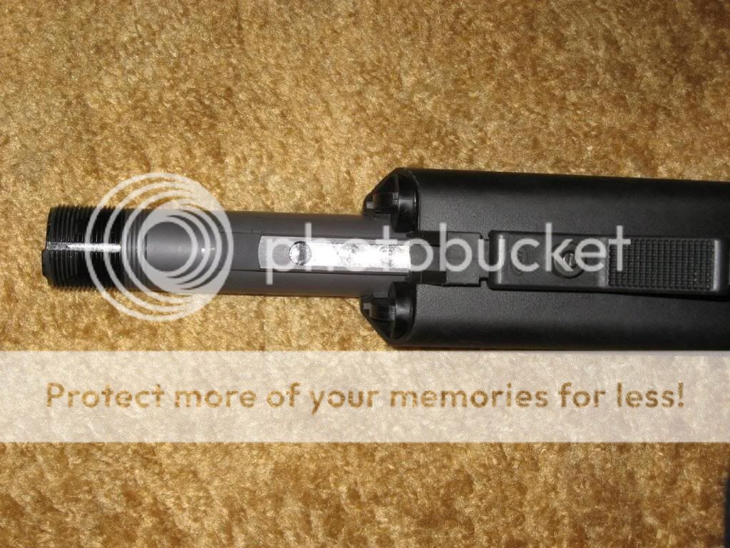

Side by side with the EE tube.

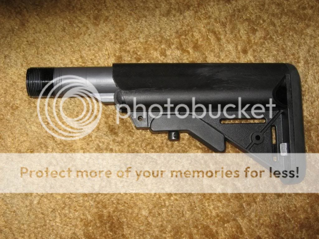

Here it is with the machining finished.
I was thinking of getting some aluminum black, but after I put the stock on you really don't see much bare metal.
