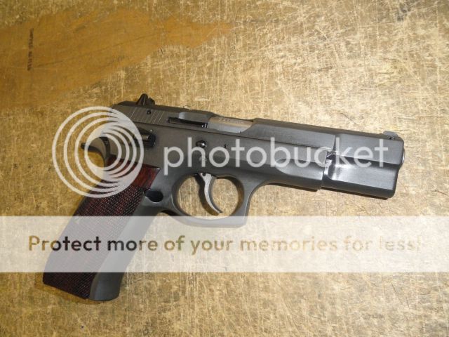

did you post your mods for the Norinco NZ85? I dont see it.
Interesting read in post 78
1. All the sharp edges were removed from the pistol.
2. The slide and frame were lapped
3. The trigger parts were carefully tuned and all springs were replaced with CZ springs;
4. The pistol was carefully inspected for any MiM or other inferior parts;
5. The grip screws were replaced
6. The safety levers and slide stop were reblued after they were deburred.
7. The pistol was sandblasted and parkerized.
8. The pistol was bathed in a solution of acetone, cosmolene and fish oil. (This creates the slightly green tint that you see)
Well, that was so nice I had to read it twice. Could you post a pic of the NZ85 from the rear? Some damn fine looking grips on that baby. Lucky cat.
