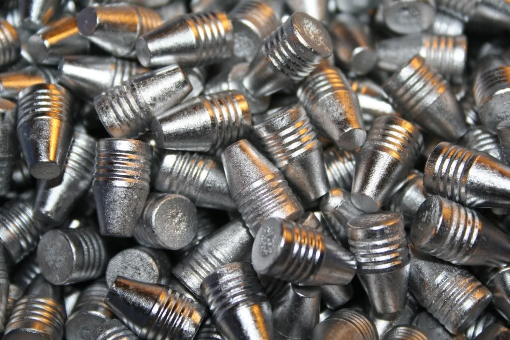

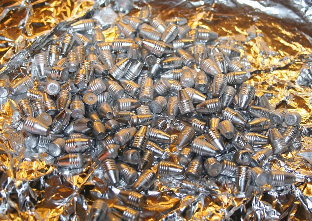

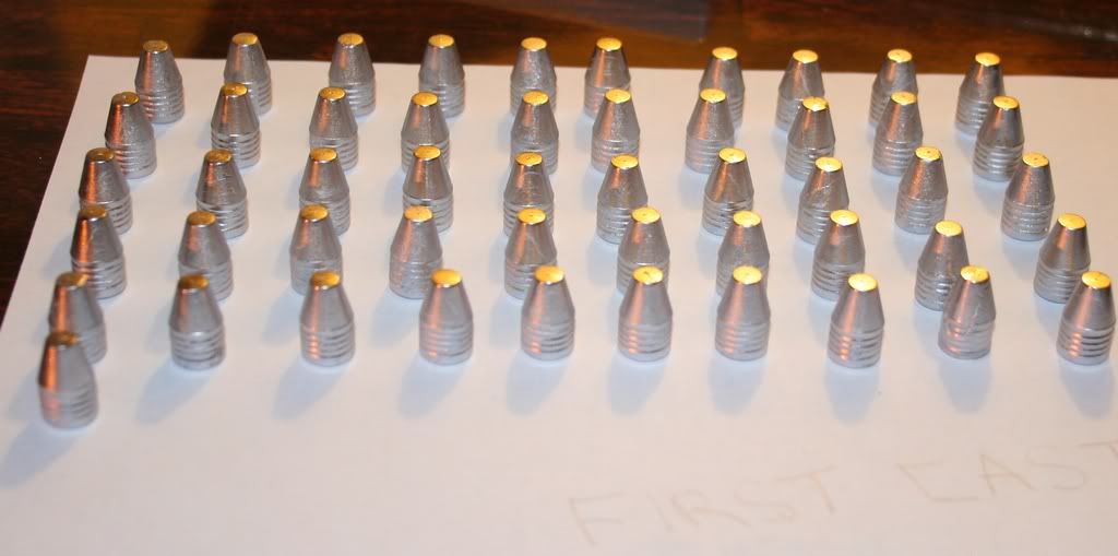

I think I casted 250 bullets (last pic contains the failures). Only ~50 came out good. My last two jobs were perfect and I stopped after that. I think I got the hang of it now.
I used melted down WW. Waiting for Xlox shipment to arrive. Well, looks like I have no zinc in my lead since I'm casting fine. Using Lee TL356-124-TC 9mm Luger #90402. Width measures pretty much at a constant 357. About 128-130grains. Will be using it for my P226.

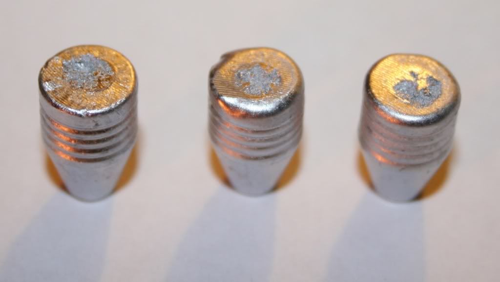

I think they're slightly froasted. But Lee says it'll be good with Alox (I will be using Xlox). So my question is, the 1st bullet is my good cast, the other two has rounded bottoms, are they okay to shoot?
Not a bad first attempt......
Bases of the bullet must be flat for accuracy, toss those ones back into the pot, Your probably not filling the mold enough, what you want is a sprue large enough to fill the funnel on the sprue plate.
Leave the bullets in the mold longer and you will get cleaner bases, you are cutting them off too soon. Smoother the base the better results you will have shooting.
Light frosting is OK but keep it down to a minimum, what it indicates you are running too high a temp on the mold.
Clean lee molds(boiling water, detergent and toothbrush). Bottom of bullets photo have a color, either an illusion or something on underside of sprueplate. Rounded bottoms are usually too cold, I preheat mold on top of electric pot while lead is melting, then dunk a corner of mold in melt for 30 sec. WW has only 0.5% tin, so adding 1% tin may help the fillout. Good luck

I filled the mold all the way up and flooded the sprue and massively at times. LOL! I may not have waited long enough to break open the sprue. My last two attempts were perfect and I stopped. I'll see how it goes this weekend. This is my first batch ever.
I don't think your lead is hot enough. The lack of tin usually shows up in the grooves and such. Your pic showed alot of bullets with incomplete mold fill.
It is caused from too cold of lead or not pouring enough in the mold. You stated you pour enough in.

That's right on the money. You're not letting the mould get hot enough. Don't worry about the frosting. It has zero effect on accuracy. Yea, it's nice to have shinny bullets, but much more important to have properly shaped, filled out bullets with sharp edges. Congrats on coming over to the dark side and saving yourself some money......or, like the rest of us....you spend the same money but shoot a TON more :D
Good looking bullets. For the ones that didn't come out good, just remelt them. The Lee 6 cavity doesn't like to work well when brand new. Get it good and hot and then they should come out better.

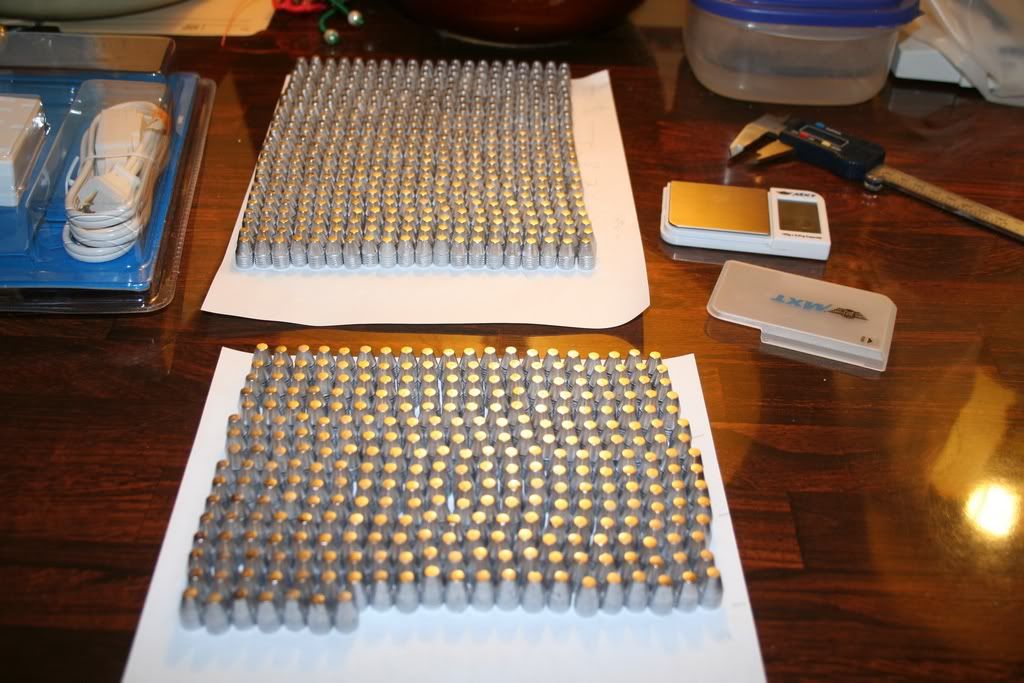

Alright, I just did a batch of 800 bullets (600 water quenched). I think about 10% rejection rate this time vs 80% first time around. I'm getting the hang of it. I have Lee ladle - way too small. I'm just using big soup spoon. I figured out a good technique that is good for me. I tilt the mold a bit down and pour lead into 1st hole and let it spill over to the 2nd, 3rd and so forth. When they're all filled, I continue pouring a tad longer. I'm essentially creating a tiny stream of lead. End result were perfect casts and very little waste lead from sprue plate. I tried other techniques, but this method seems to work best for me. Next batch should yield near perfect casts each and every time.
If this works, this is about $80 worth of plated bullets. I just need to cast about a thousand more to get my casting equipment and lube $$ back. :)
BTW, I'm not lining bullets up like that anymore. Just a waste of time. LOL!

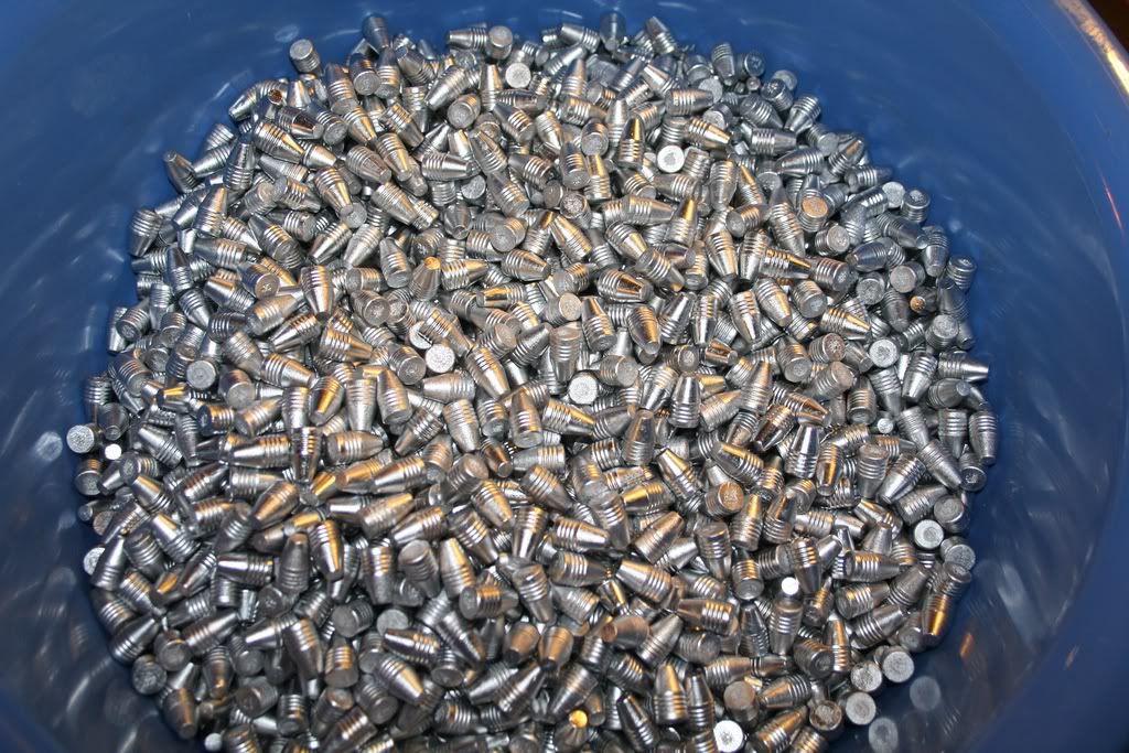

Thanks! Before winter comes, I took advantage of today's nice weather and casted 43lbs of bullets you see here in this tub. I got pretty damn good at it. Less than 1% rejected. :)
That's about 2300 9mm bullets at around 130gns
Cost: ~5.5lbs of liquid propane (5.50*.60 = $4.50) and 4 hrs of work.
