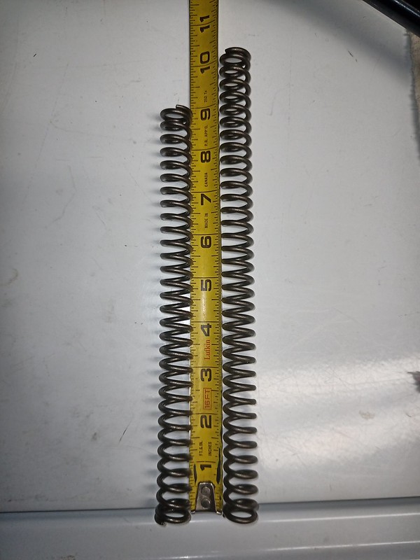

The new spring is about 1.25" longer than the stock spring which seems odd as this is a rebuild kit for the gun not an upgrade kit. I bought the kit with the rifle.

I've attached some photos of the parts from when I was happy and making progress.
