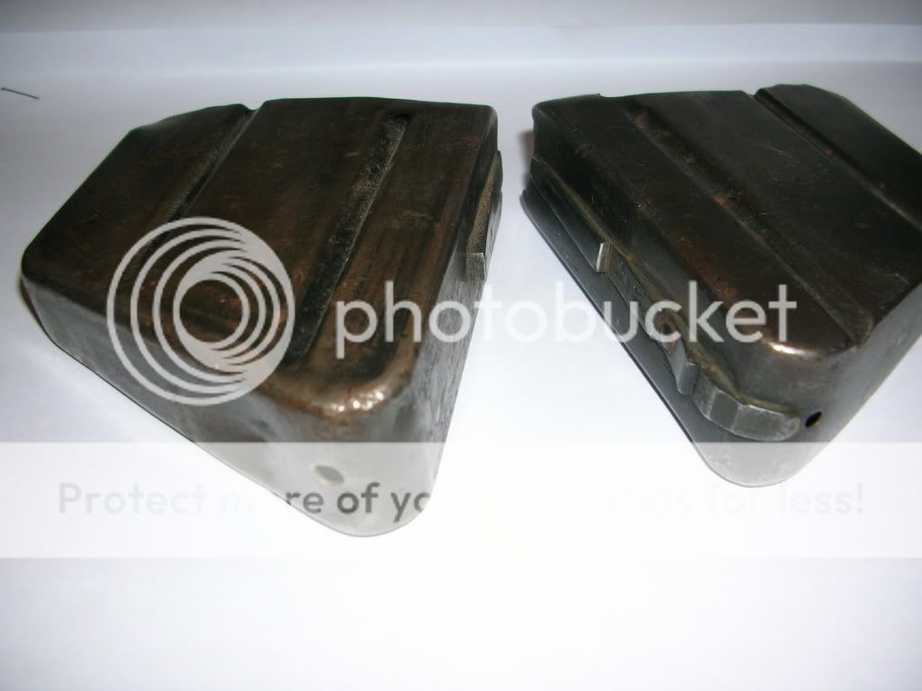

On the other hand, someone has taken a fine, scarce, Long Branch rebarreled, Canadian marked SMLE and reduced its value to approximately 1/4 of what it would be like if original. Also, your magazine is sticking out way too far, and may be a Number 4 Lee Enfield rifle magazine, not proper for the No. 1 Mark III SMLE rifle.
I think No.4 mags have the grooves on the side going all the way to the bottom of the mag, these stop about 1/4 inch short. Should be the correct mag, maybe not driven home all the way.
Lee enfield magazine differences
I think you are going South, when you should be headed North.:)
The correct magazine for the Lee Enfield Number 4 Rifle does not have grooves all the way to the bottom of the magazine.
The correct magazine for the SMLE Number 1 Rifle does.
A better identifier is the rib on the back of the magazine where the magazine release catches to hold it in place. The Lee Enfield Number 4 Rifle magazine has a protruding rib that extends only about half way down the back of the magazine on the outside of the magazine case.
The correct Number 1 Rifle magazine has a rib that extends fully down the back side of the case, and slightly (about 1/4 inch) across the bottom. About 1/2 inch up from the bottom there is a thin steel piece attached to the magazine with a rivet.
The magazine for the Lee Enfield Number 4 rifle is on the left. The correct magazine for the Number 1 SMLE is on the right.
