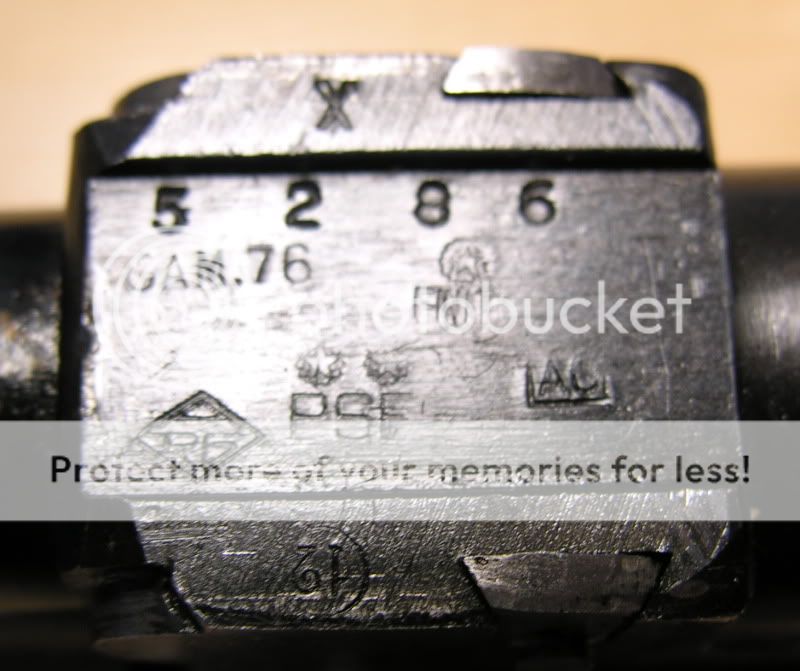

I emailed Renato the serial number and they told me it was manufactured between 1970-1975. There is a stamp on the barrel that says CAM.76

Pdubois64, that is a nice gun. Renato Gamba makes fine firearms. While the Icaro was not one of their top of the line offerings, it is a great game gun.
The top barrel will be full choke and the under barrel modified choke. The chamber length will almost certainly be 2 3/4 inches, and the gun was never made for steel shot.
A photo of the proof marks on the bottom of the barrels (with the gun broken down) would tell more, and a close - up of the engraving would be much appreciated. Also of interest is what the gun weighs.

I will try to get some close ups of the marks and the engravings and post later today.
With the value of my trade and some cash I got back I paid about $650. I didn't think it was a high end model.
The CAM 76 is the chamber length in millimetres. Your gun has a 3" chamber.
The stamping AC is a date code for 1977.
There should also be markings on the barrels such as 18.x which would be the nominal metric bore diameter and other numbers close to but less than 18.x which would be the choke measurements.
The PSF is a provisional smokeless proof and the Finito is final proof. The bordered RG is the makers mark.
