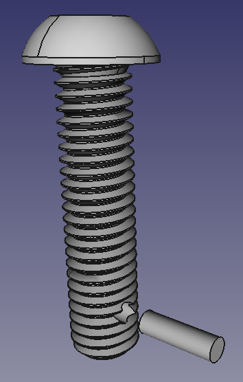

I simply drilled a small hole (1/16" I think) across the threads of the handle and pushed a plastic dowel into the hole (an M2 nylon screw will work), making sure to leave it extend beyond the threads of the handle so it creates friction. I did this on the drill press, but if you're careful you might be able to with a hand drill too.
Here is a 3D rendering:

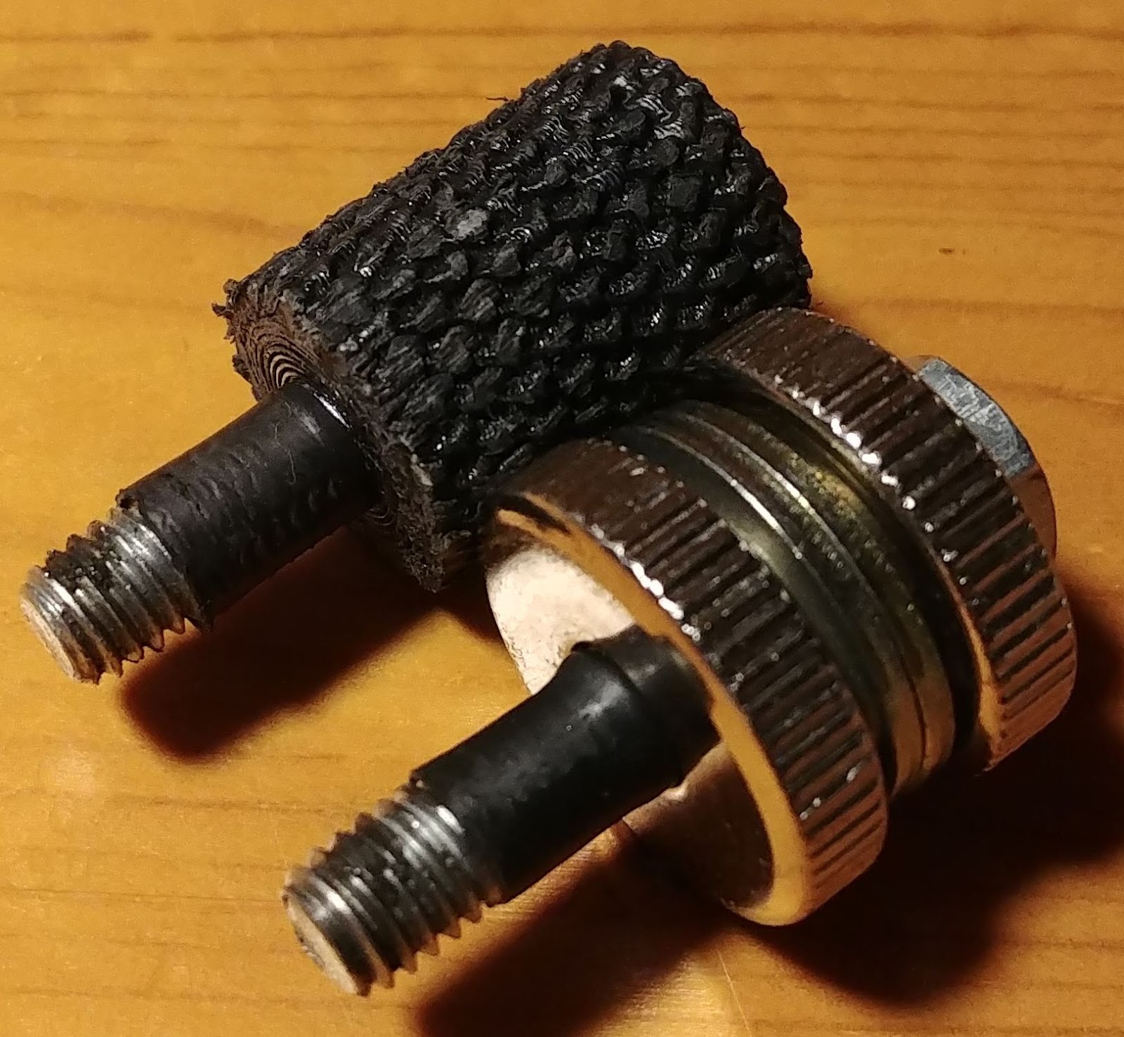

And here are the results:
1ZK7dyW-ilhx8QEhp6-YTzz1GFFIGAvF-
Note the DIY handle I made with an M6 bolt, 2 knurled nuts and a couple of washers.
