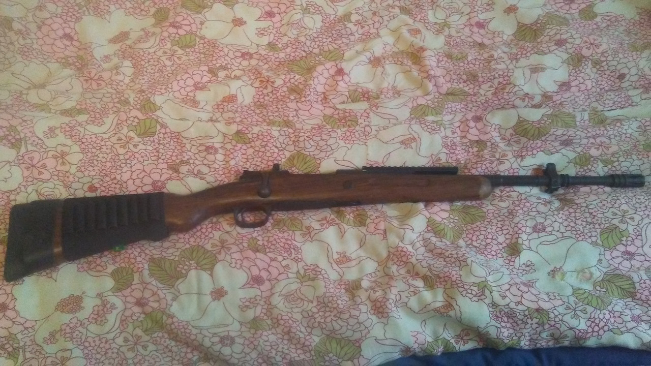

FWIW, this is my FR-8 "mutt" (and yes, it was sporterized - weirdly - long before I became the owner):
At $200, it was a decent enough .308 "knockabout" rifle - but I sure as heck cannot figure out the weird things that were done to the poor thing... :yingyang:
And well, as for that bedspread, it's in the guest room... :p
There is something about a short rifle with a long sight radius. I think they are under appreciated for the versatility they provide for the vast majority of realistic situations.
For $200, I'd say you got a better rifle than if you'd spent$700-$800 for a modern commercial plastic stock .308
Looks like the previous owner drank the "scout Rifle" Kool-Aid, with that pic rail forward of the receiver. To be honest, the Scout Rifle concept is a road I'm going to drive down one of these days.
I can assume you're not interested in guests staying long enough to become roomies, and the bedspread is encouragement along those lines.

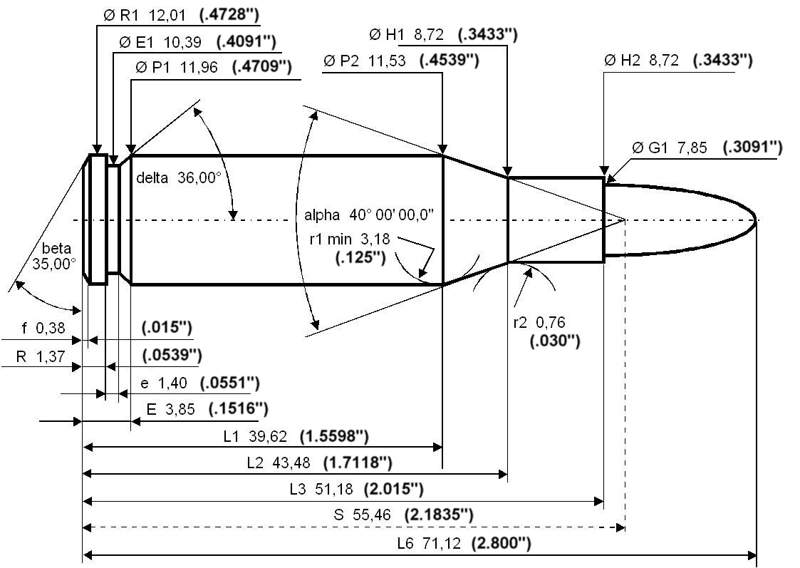

As for the finicky first round... That's a whole different kettle of fish. The internal mag is the same mag that was used for the original cartridge - 7x57 Mauser, which was both longer and had an ever so slightly wider case than 7.62x51 NATO (pic diagram below), and the only read modification they made to it was to add a block at the front of the magazine to shorten it. But the case width difference is so slight, that how the rounds end up stacking in the internal box, is going to have more to do with the mnanufacturing tolerances of the magazine than anything. I've seen videos where they seem to run flawlessly, and other videos where guys have a lot of feed problems. It's very much a case of Your Mileage May Vary.
I have a suspiscion that if I was to spend some time really looking at the feed lips, I'd be able to get rid of the problem with a bit of slight metal bending, but it isn't a big enough issue for me to really want to bother and risk doing a Bubba to an otherwise very nice and unmolested milsurp.
7x57
7.62x51
