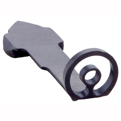

Rusty, I just took a look at Skinner's site and they are making quite a few new model specific rimfire peeps including one for the SA 22!
It's at the bottom of the page....
http://www.skinnersights.com/rimfire_groove_sights_25.html
Thanks, didn't see that on his site before. Looks like a solid piece, I have a Skinner peep on an old Marlin 30-30 and it's a nice piece of work. A bit pricey especially with the exchange right now but would definitely be an upgrade.
A cheaper option rusty might be to make a peep using some metal banding or other on hand thin metal, and replace the adjustable notch portion or the rear sight with the new peep blade.
That does look great but it appears the Marbles sight is 1 7/8" long and there's only just over an inch on the JW-20 from the rear dovetail to the barrel lock ring. We had a big snowstorm last night and this morning, I was bored and out in the shop so this is what I came up with what I had on hand. Seriously doubt it'll be permanent, just something to fool with.

One thing to bear in mind is that there is ONE difference between the Browning and the JW-20 - the dovetail for the rear sight is smaller than that of the Browning. So, if you want to add a different sight (I'm thinking of a peep, myself), either the sight will have to be filed down, or the barrel dovetail will have to be enlarged. I'm leaning towards opening up the barrel dovetail to a more standard size, as that would open up the range of available sights enormously.
IIRC, the Browning has a 3/8" dovetail (same as the Ruger 10/22, among others), and the Norinco has a 5/16" (or metric equivalent thereof) dovetail.
