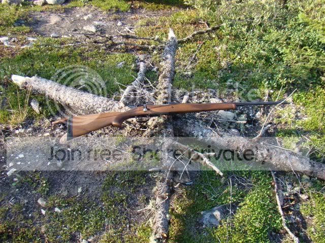

Last week,I bought a Herters U9 Custom in .458 Win. mag. from a fella that
ordered it for himself back in the 60's. He let me have the beasty for a
mere $750.oo and it's a beauty. The metal is in A-1 condition, the bore is
pristine and the walnut stock is very nicely figured and dent free.
The barreled action is a BSA CF2 long action with a Douglas premium tube,
and is fully bedded in Accurglass from the factory. Trigger is adjustable and set at 3 lbs.
The only buggaboo is a missing front sight insert which I'll soon correct.
The owner had only put about 20 shots through this gun and gave me 2
boxes of Winchester brass and 2 boxes of Hornady 500 gr. solids that
are in great shape for their age. The price tag on the brass is $6.95 for
20 & the same price for 50 Hornady solids! :eek:
Anywho, after strippin' the gun down and cleaning, I mounted a Weaver
K-4 w/post reticle on 'er and handloaded up 20 rounds using 30.0 gr.
of SR4759 powder held in place with kapock filler and hit the range today for
initial sight-in. This load gives a bit over 1200 fps. with the jacketed 500 gr.
slugs according to the Lyman 49th edition handbook.
After a quick 2 shot sighting at 25 yds. to get a high center hold, I moved
on to the 80yd. target to put 3 more shots on paper and adjust the scope
for windage, but not elevation. As the photo shows, the first 2 shots were
tight together. I then gave the scope 4 clicks to the left to center it up
and fired the 3rd. shot to verify the scopes' adjustment capability.
The rest of the ammo was used on the 200 yd. gong and to knock over
a 4 inch arbutus tree at 50 yds. The drop at 200 yds. for this load is
only six inches or so. Those big slugs carry well at that range and really
smack the gong with authority. The recoil with this load is quite tolerable
from the bench, and felt about the same as my buddy's Browning 71
in .348 Win.
I'm more than satisfied with this rifle/scope/load combination, and will
use it for both hunting and plinking. For hunting I will use 500 gr. cast
bullets. :)

I had to add more pics of this rifle. The wood on 'er is too nice not to share.
Definitely my nicest gun in the safe! A bit of polishing on the bolt knob
as well as front sight replacement, and she'll be done. Me happy. :D
