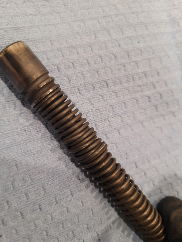

Hey guys, new to the forum here but just wanted to add what's going on with my M10x.
Bought late May this year W09### serial number. From new it shot about 250 rounds of norinco Noncorrosive red box, barnaul, psp soft point, some China surplus blue/white box and a good bit of Serbian surplus brass case.
Not many feeding issues, maybe about 6 light primer strikes, and did have a couple stove pipes here and there and cartridges not extracting at all and getting jammed in between the blot carrier and the chamber/wall.
Recently went to the range and shot about 100 rounds. Towards the end of my range time, I was getting failure to feeds every 3-5 shots. This was extremely high malfunctions compared to the typical stove pipe every 40 or 50 shots.
Took the rifle home and disassembled it and noticed my pistol spring was broken near the piston end. I sent the pictures to the M+M contact on Reddit and they told me it's because the spring got cooked, lost its strength and snapped. They said that it should be covered under warranty so I opened a warranty claim on the m+m website. I have not heard back yet from them but I will update with info when I hear back.

Lol. Piston spring got cooked with 5rd mags?
I hate to jump on the M+M hate band wagon as someone who has enjoyed their products, but that's nothing but a excuse for poor craftsmanship in my opinion. I have never heard of this issue with a Swiss 550 series which uses the same design principles.

I felt like it should be able to handle a bit more heat than that aswell. Maybe just a bad spring, I haven't heard of this issue with anyone else's M10x.

Update!
I got the rifle back from North Sylva about a month after I sent it out. They replaced the spring and nothing else. Since then I've taken it to the range for more testing with different ammo and have made some real progress on getting to know this rifle. I found a Facebook group of owners and found a bunch of info on there and made some slight modifications to the rifles receiver and bolt. After another 200 rounds or so with the new spring and some minor filing done, the rifle runs much more consistent and better than ever. The results are as follows.
