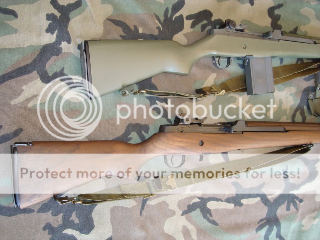

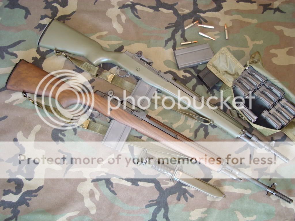

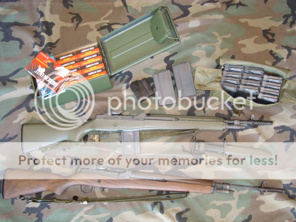

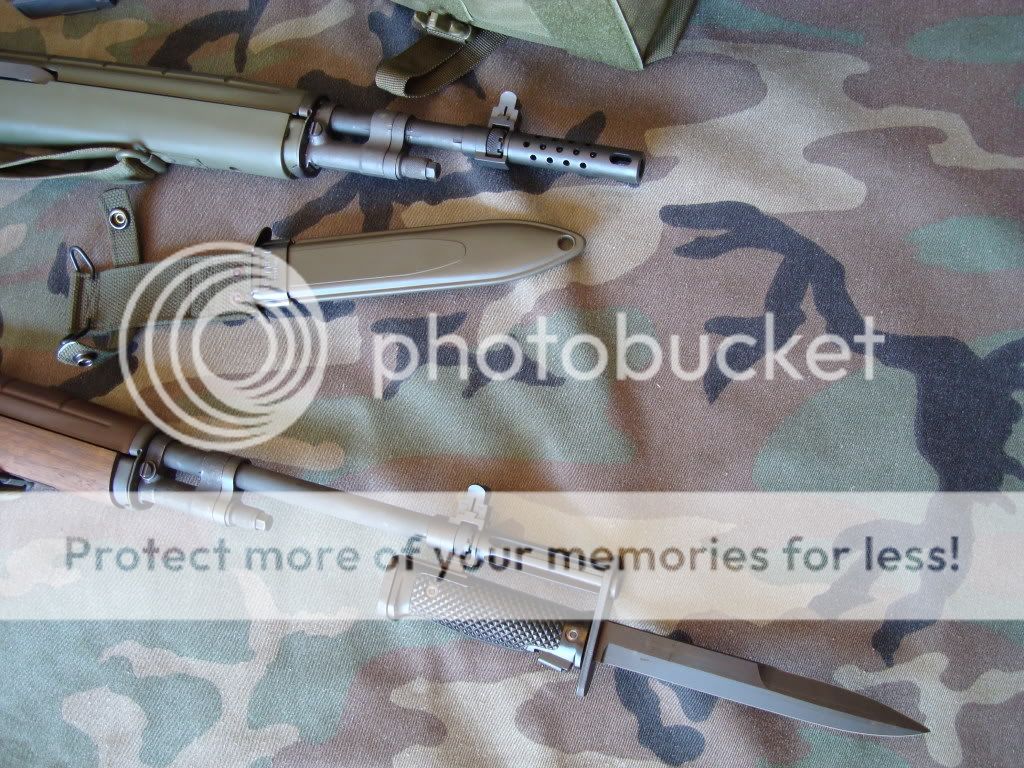

It began with a Canada Ammo M305 shorty. Out of the box it seemed like a great rifle, but being new to the platform and chinese clones I wasn't %100 percent comfortable shooting it due to safety concerns. So I sent it off to the man formerly known as the M14Doctor to have it checked and accurized. Then I happened to see an ad for the Springfield M1A's at Wanstalls and couldn't resist ( I told the girlfriend it was my "registry is dead" rifle - did not tell her the price! ). Gary hooked me up with a Standard M1A ( headspace 1.631 ) with a walnut stock that I have since added a flash hider with bayo lug. Then I just had to have a bayonet ( nib 1966 ), Vietnam era sling ( according to ebay seller ) and a few spare mags. I recieved my M305 ( headspace 1.638 ) back early this week and added my Springfield muzzle brake. I can't get enough of shooting these rifles, I enjoy shooting offhand and I it seems like I can't miss! I'll be using these for hunting this year. Every deer I've ever shot has been with a Win 94 30-30, so this will be a new experience for me.
Here are some pics'

The internet has decided that AE 308 ammo in the M1A rifles isn't a good idea, check some of the other threads, you might be blown away with what you find hyuk
i thought AE ammo was bad to reload. i hope thats the case because i bought over 1000rounds of AE. btw nice guns and share some of those mags they're hard to find.
Pfff, you'll be fine with the AE ammo. Fine to reload it too . . . IF you know what you're doing. Based on what I've seen of the recent AE/M305 incident there is a lot more too it then the ammo.
You seem to know what your headspace is, that alone suggests to me you observe your rifles with enough attention to detail to assure their safe use. That's more then others know about their rifles that have probably blown 1000's of rounds of AE without incident. Hell, I couldn't tell you the headspace on my M305, but I can tell you that every single round I reloaded for them passed GO before I loaded them.
