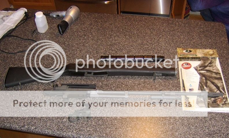

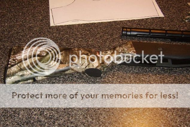

Step 1: Disassemble your rifle
Step 2: Clean all the parts you wish to cover with a degreaser and oil remover. I used rubbing alcohol.

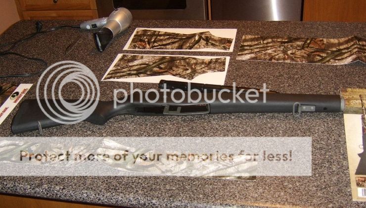

Step 3: After letting dry you can start applying the pre-cut pieces. I would start with the butt.

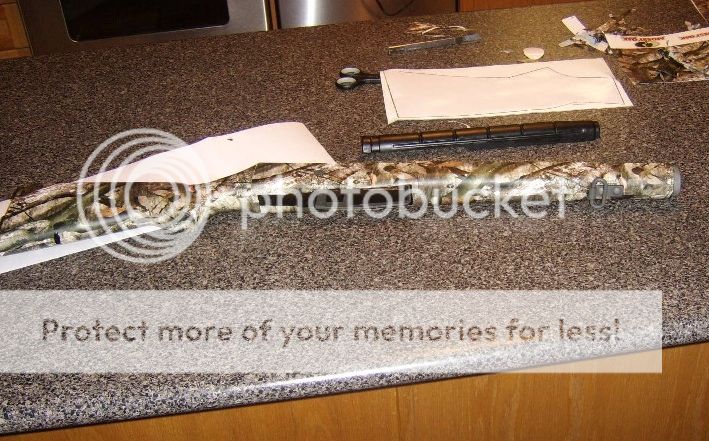

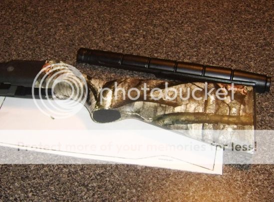

Step 4: Slowly work the vinyl down and you can use a hair dryer or a heat gun to make the vinyl more pliable.
Step 5: trim off any excessive material.
Then just take your time and work your way over the stock doing one section at a time. It took me a little over an hour to cover the stock. After I finished applying the graphics and trimming, I went over the entire stock with heat to set the graphics. The video’s on there sight are super helpful and I’m happy with the end result.

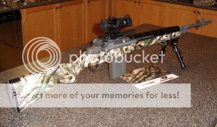

So here you go the finished product, one M14S in Treestand Camo.
