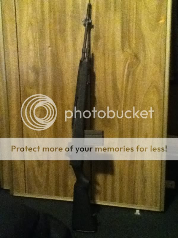

After reading about all the "fun" everyone here on CGN has with the M14 platform i decided to give in and buy myself a headache... Here she is.

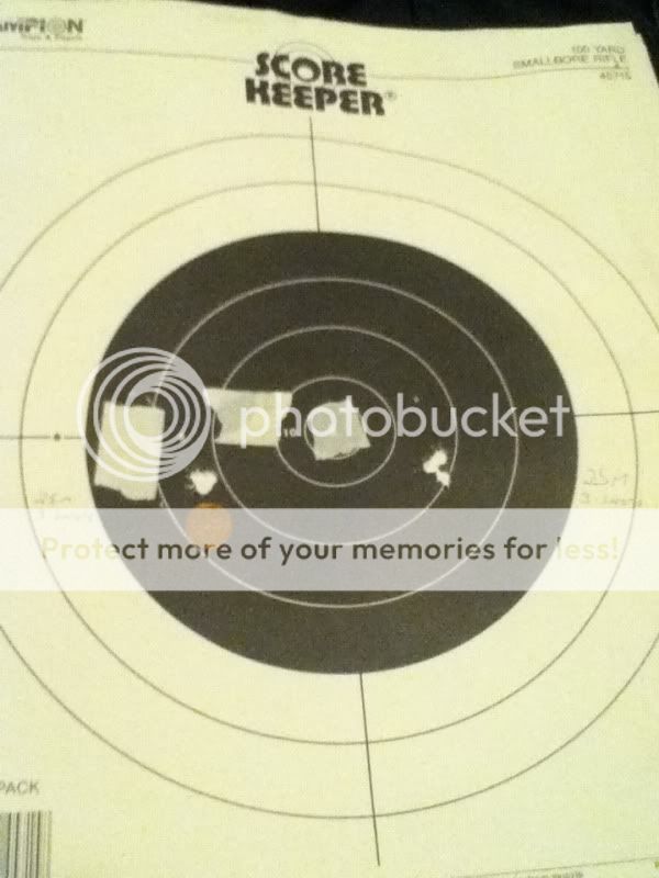

I spent the a few hours at the range yesterday playing with the rear sight as i expected i would but in between chit chat with some rangers and wadeing thru 3' of snow i did manage a few decent groups at 25m when i could keep the rear from walking around.
I gave the elevation a couple extra clicks, banged the front blade over and jambed a cleaning patch under the windage knob and shot this group.
Not bad for a battle sight on a chilly northern AB day...
Just picked up a case of .308 ammo today, will have to go back out next weekend and see if i can do that at 300m next time... Anyone got some snow shoes i can borrow? Lol

Not going to get the garamd sight just yet... When i figure out how to get this one appart i might be able to fix it
look for something like " how to fix the garand rear sight"- it's also in the shop manual- the big thick one- they're IDENTICAL but the m14 one is marked in meters- i just went through this a couple of weeks ago-if it's the same thing, and it's windage, you need to loosen or tighten the nut on the right hand side - inside the elevation knob- it's called the WINDAGE KNOB NUT- AND IT'S DeSCRIBED ON PAGES 38-39 of fm23-8
i hope the heck you LOOSENED the hex nut on the FRONT SIGHT before you " BANGED IT OVER- the whole rifle is DESIGNED to be taken apart in the field with that combo tool and a couple of hex wrenches- you shouldn't BANG on anything- if you do, then SOMETHING is wrong- or you're misinformed - the only thing that SHOULD need a hammer is removal of the flashider, and that needs a grinder or dremel as well-
it also makes me wonder -ARE THE CHINESE ONES coming with NO MANUAL or are the people purchasing these things FAILING TO READ IT?
you should only adjust your front sight AFTER you've adjusted the rear as much as possible and still can't get a ZERO-

Actually my FH was not welded, someone staked the front sight blade with a chisel in the far right position... There is no good reason to bang on the sight blade EXCEPT when some child labourer pins it with a chisel.

Why wouldent i adjust the front sight blade? It was as far to the right as possible and i had the windage 1/4 of its travel over the middle?! Now the windage knob is on center and the sight blade is allmost dead center (indicateing hopefully my barrel was not over tightend at the factory).
I tried a box of federal 150gr blue box in it and shot 3x 5rnd groups around 4" and one a smidge over 3", the mfs ammo shot under 3" every time with the odd flier from my teeth chattering.

Here you go Hotwheels...
To remove sights follow these steps:
First adjust windage all the way to the left as far as it will go.
Next, undo the windage lock sleeve with flat blade screw driver, turn until loose, do not try and remove, collar is held in with a retaining clip.
Next, with collar loose, undo the windage knob and remove the knob.
Remove elevation pinion by pulling out of sight base
Remove aperture
Insert flat blade screw driver into aperture area under sight cover and gently pry up until it springs loose.
Done.
Clean and regrease all parts
Install sight base and rear cover together
Dab of grease to receiver at sight location recess
Use flat blade screw driver under back of sight base on bottom lip of sight cover and push firmly, sight cover should snap into place
Next, install aperture
Next install elevation pinion, ensuring it is completely in and meshed with aperture.
Slide sight base to the left side
Install windage knob and hold with your thumb, turn the lock collar only in a reverse direction until you feel it sink in a bit it has now engaged the pinion shaft correctly
Next turn the collar with screw driver forward until it comes just snug
Then turn windage knob to engage with sight base
Adjust lock collar as needed to tighten or loosen the sight knobs

Ya I believe we cleared that up on pg1, the nut inside my Windage knob is partly stripped allowing it to back off when I rotate that knob... Lock-tite to the rescue!
