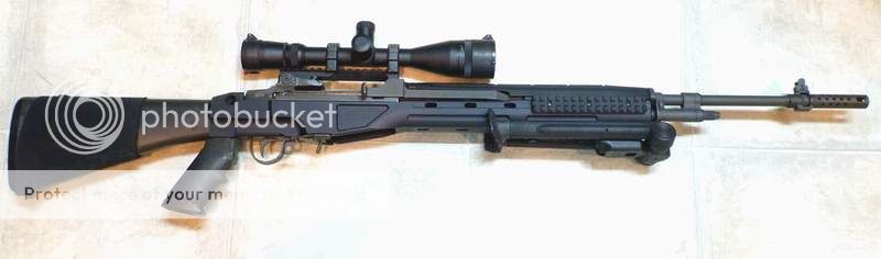

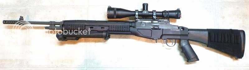

Hello all!!
Some of you may recognize me from the Black Rifle forums.

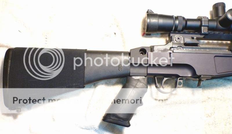

For the most part, I really don't post pictures any more of builds. However I am so pleased with how this one turned out I thought I would share.
Near the end of 2012 for various reasons, the M-14 style of platform once again peaked my interest.

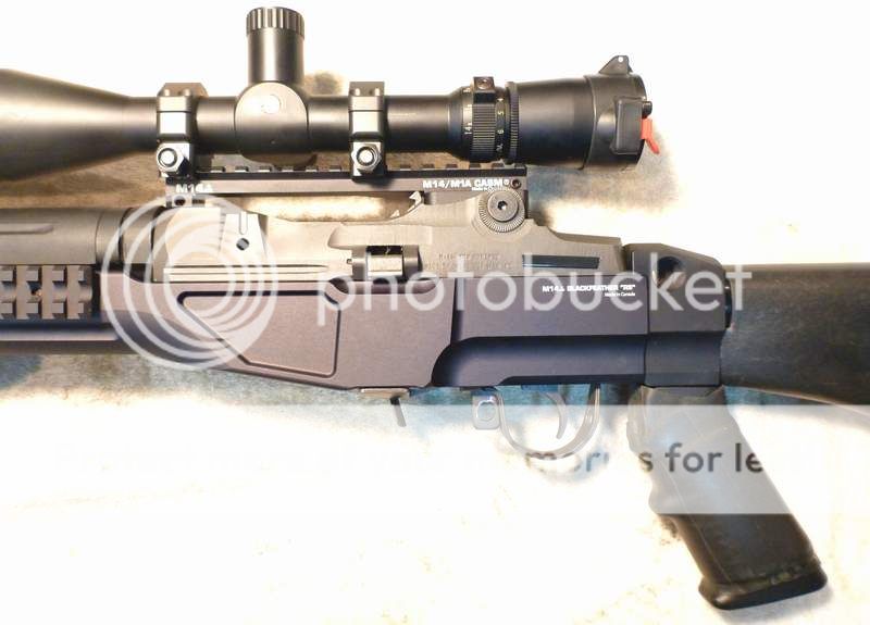

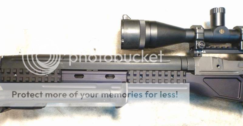

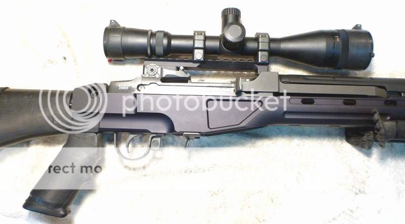

One of the most exciting developments for the M-14 platform has been the Black feather chassis system, in conjunction with the CasM optics mount.
Finally there is a solid, repeatable solution for mounting conventional optics. The only down side is you have to be “alright” with the lost of the rear sight, as the rear of the optic mount sits in the rear sight pocket. This gives it, its solidness. Couple that with a light, ridged, and affordable chassis system, and I think you have a real winner.
While I am relatively new to the Platform, I learn relatively quickly, and I have a few friends that can help out. ;-)
I got together with a smith friend of mine, and we started to chat about the possibility of building a DMR style rifle on a 22".
The aim of this project was to
-change only those parts that offered the greatest amount of value for the dollars spent (IE spring guide, muzzle treatment etc)
-retain as many of the original parts as possible, and simply tune them for optimum performance.
The following is the fruit of the mentioned discussion. Its not quite in its final configuration, as the ergonomics and optics arrangement still need a little tweaking, but its close enough that I thought I would share some pictures.
Some of the parts included
  • A-1 stlyle but stock, with stock ammo sock, and QD style sling swivel
  • A-2 Ruberized grip
  • Black arrow Fluted Steel spring quide
  • Tango Down Advance combat bi-pod
  • Leupy 4.5-14x40 with AO, mil-dot, after market windage turret, Kill flash, and bulter Creek flip up cover (this is a 1" tube)
  • Optic is held in place by TPS 1" rings

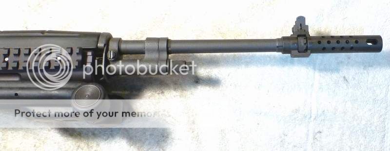

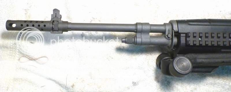

  • Genuine Springfield Armory M1A muzzle break
  • I am waiting on an Extened mag release, and Extened bolt release from ArmTac. (not shown)
To date I have not really had a chance to shoot her in earnest. However I can say that the live-fire testing with various ball (both brass and steel cased) at an indoor range was very promising.
Pictures as follows. I will do my best to answer any questions you might have, and I look forward to any constructive comments you might have
regards and all the best
AbH

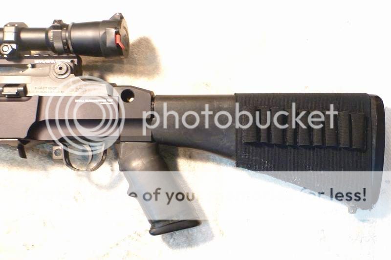

Looks pretty good. The Black Feather sure looks like a winner!

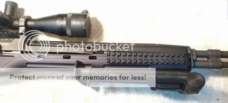

How do you like the bipod Is that an innertube on the grip?
Can-down
Thx for the kudo's
There are some things that I really like about the bipod
-compared to others its light and suprisingly strong
-does not really seem to effect ballance
-the legs lengthen enough to shoot well from prone, and over 12" tall grass
-it pivots well from left to right
My main beef with it is it does not swivel, so getting it level can be a pain.
Yes, some one aplied inner tube to that grip, in the Pat Rogers style.
I really like how they have done it, as they actually built up the grip. They did a really great job, and I would like to be able to replicate it.
It may not be very pretty, but it works really well. I want to take it apart and figure out how they did it, but I simply have not had time, and I keep moving it from build to build.

Love the look very nice. Like it alot with that A2 stock.
I've done something similar but with a 18.5" barrel. But I'm missing some parts like Flash hider, scope and rings for the scope.
May I ask. Where did you get that flash hider?

That is a Springfield Armoury M1A muzzle break, and I got here on the CGN EE
Hope that helps.
