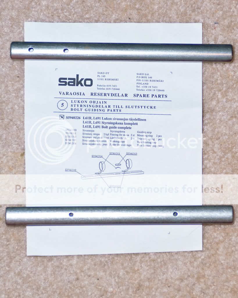

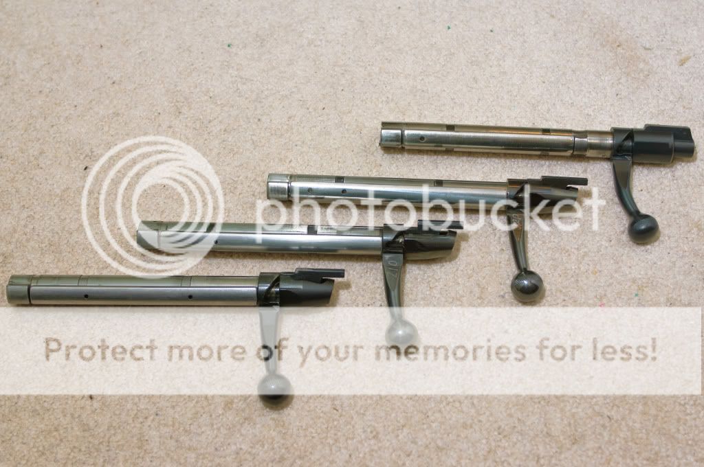

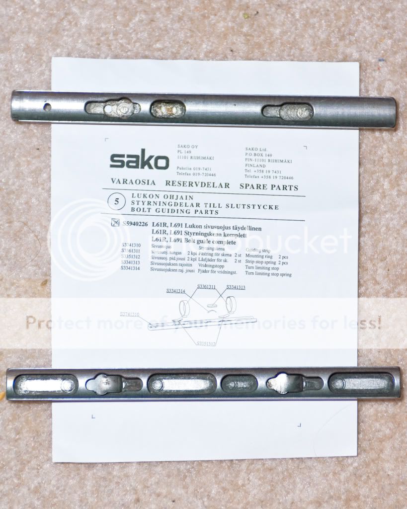

makes my 9.3x62mm look tiny ;) Very nice looking animal. Just a tad of info for you I'd recommend putting an updated bolt guide stop in that thing. I imagine it is going to thump a bit & you do not want what happened to me last season.
The guide & the bolt on the bottom of the photos is the updated one.
My 338 Gaillard locked up last year. Thankfully it was only a coyote I was shooting at & not the trophy of a life time when it failed.
Just trying to save you some frustration in the field ;)
Stoeger carries them.
