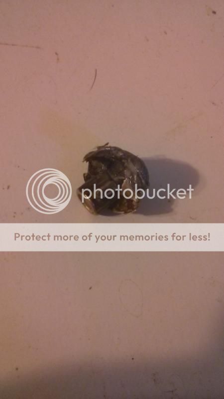

Pics were taken on a buddies phone. This was my first big game and I am still jazzed about it. Went almost 5 days without seeing any sign, then Friday my camp took a doe, and I got the buck this morning.... Same exact hide for both.
