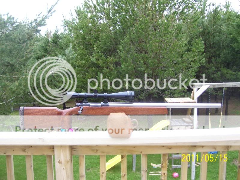

Well I finally got it together rem 700 action gaillard heavy varmint 1-8 twist in 6 br and my homemade stock bedded and steel pillars.
I might be able to shoot it saturday at the shoot if it dont rain again I swear it has been raining here for a month.

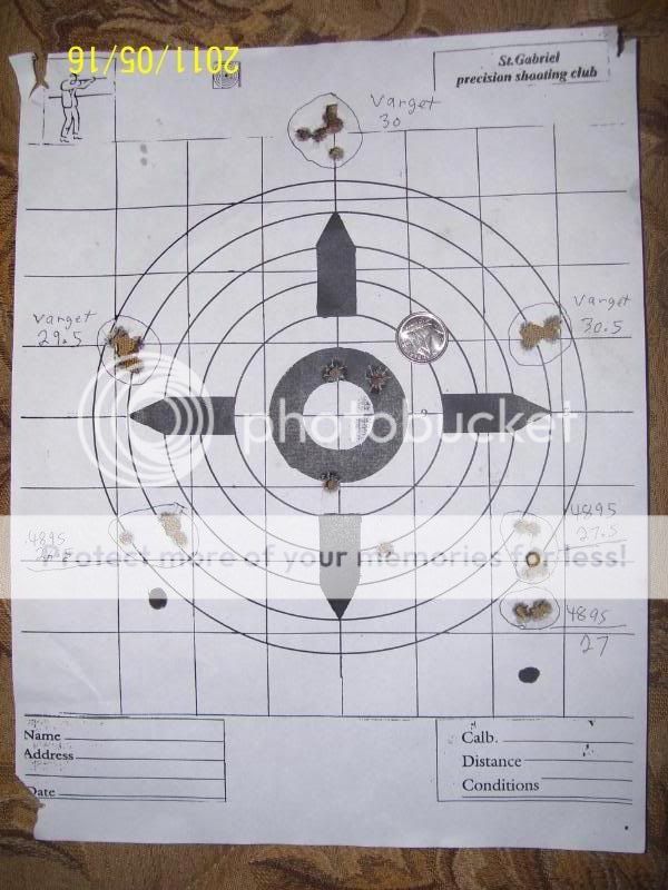

I was at the range today and worked up a few loads seems to like varget and H 4895 now I need to bring my chrono out to find out what speed I am getting and fine tune the oal.
I shot these at 100 m all 5 shot groups
what bullet are you shooting?
I was shooting some 90gr lapua scenars that's all I have on hand for now I want to try some berger 105's and some sierra smk 107's .
Now that I got some brass fireformed I am going to head back to the range tonight and try a few more with a different oal .
I have a Savage heavy barrel and it likes 105-107 grain berger and A max with 28 grains of Varget. It seems to be sensitive to OAL, I am waiting for a calm day to do some research.
@coyote came by the RNBRA shooting this weekend with his rifle, I can confirm that it is as good looking in person as it is in the photo. He also took us on a tour of his gun club, St. Gabriel Precision Shooting Club and all I can say is wow!, what a gorgeous 600m range that is.
Thank you for the compliments Daniel I am looking forward to shooting with you guys again , we will try and make it to gagetown for sundays shoot.
