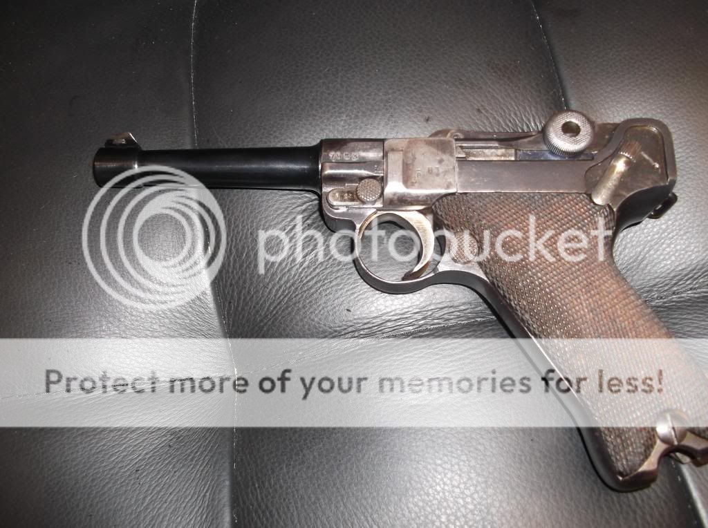

Hey Desert_Fox - thanks for that. Your question made me think I should post a pic, so here it is. The pic makes the frame look lighter than it is, but there is a really noticeable difference.
It's definitely a shooting piece, not a collector, but I'd like to make it look as good as I can.
Nice salty rig!!
Personally, I like original finish the best, and seeing the rest of the gun, I might try removing the original blue and using the amateurs cold bluing stuff you'd buy from CanTire, I did that on a Tokarev slide to get the same type of finish that the rest of that Luger has, your results may vary.... ;)
Have a pro refinish it. If you get a crappy tire home blue kit and you have no experience in refinishing firearms this is not the one to learn on.
I'm with you on the look - guns should look like they have some history.
I think I might try that barrel approach. I've had some luck with custom bluing before. Never removed blue before, but it seems straightforward enough. (Famous last words...)

FWIW, I would NOT use a cold blue kit. The RIGHT method is to rust blue it. You can then control the amount of finish by number of applications, it won't smell funky, and it will be durable.
I like the Laurel Mountain Forge stuff - you can order it from Track of the Wolf.
Tagged for interest. I have a Luger buy in the works, and it will have to be rebarreled as well. The bluing appears better than on yours, but I'm very interested to see how this plays out for you and how good a match you end up with. please keep us posted on your progress.
One way to blend the "new blue" on the barrel is to oil and use a 'scotch pad' or 'steel wood - 000 or 0000'.
With oil, either abrasive will remove some of the new blue without scratching in the finish or damaging the metal surface. The blue should turn into a blue-grey and you control how much finish you wish to remove. This avoids re-bluing the barrel.
During the first shipment of RC K98's I used this method to 'age' some K98's with great effect.

You can add a LOT of holster wear with ONE piece of Crocus Cloth.
Takes about an hour if you do it right.
While it's true you can do it this way, the remaining finish will still not be a color match. The original gun looks to be a rust-blued model.
Another way to do finish removal that looks authentic is to wear a glove doused in talcum powder and then just handle the barrel while watching TV. this will simulate actual wear and accentuate the high points.

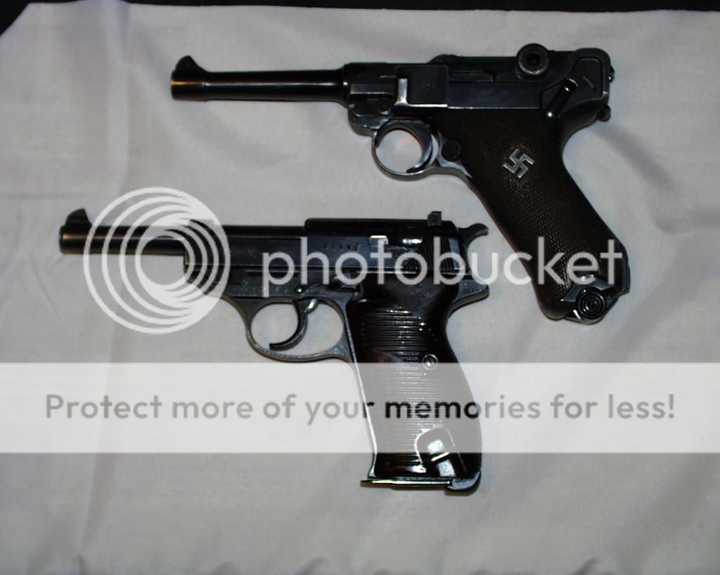

Here are the pics of my P.08 Luger with its new Restricted only barrel. (Don't mind the matching byf43 P.38 in the picture...)
Crazy thing is, side by side, even with an original length "short" barrel, the Luger is actually longer than the P38... Yet apparently, the Luger is exponentially more concealable and more dangerous than the P.38.... f:P:
*Yes, I know it's the barrel length that matters, but C'mon!!*
