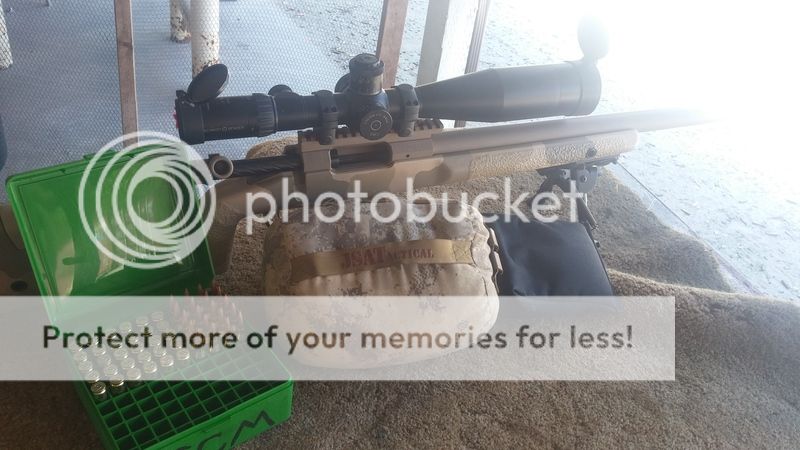

I got a reamer and a kreiger barrel and decided that since I love PGW rifles I wanted to build it on a coyote action. Got a hold of the boys there and they said no worries. Shipped off the reamer and barrel and soon enough it was in my hands.
Time to fireform some brass. I didn't want to burn up my hybrids making brass So I bought some Nosler custom competitions and powder up 47 yrs of H1000 and away I went. Break in a rifle with shooting and cleaning isn't my bag nor does PGW recommend it So to work I went. Keep in mind this is fireforming with zero load development.
