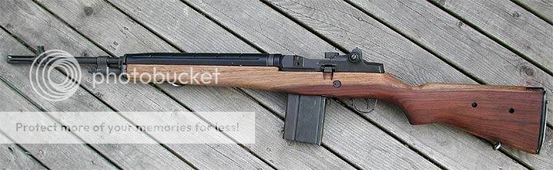

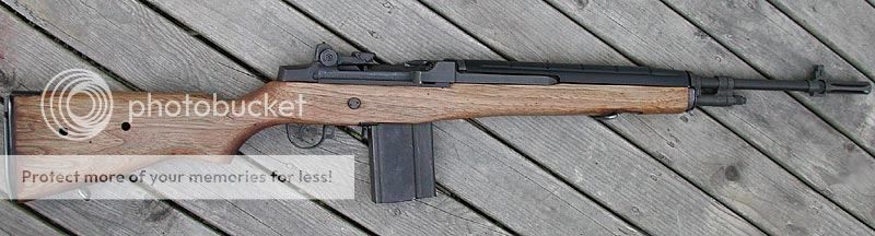

I had originally thought of using one of Krylon camo paints on the stock, but after reading Skullboy's caution regarding painting wooden stocks I decided to sand and oil the stock (and although I do like--a lot--the look of some of the camo'ed fiberglass stocks on the board here I will confess to being partial to the "old school" look of an M14 with a wooden stock and black handguard). One advantage of the wood being fairly soft is that the old finish sands off fairly easily. Here are the results--I'm fairly pleased with how it turned out and was quite surprised how much grain was buried under that thick reddish brown finish. Once my Portuguese ammo shows up from Wolverine I'll be all set!

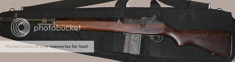

Original (complete with "speed holes" :lol: )

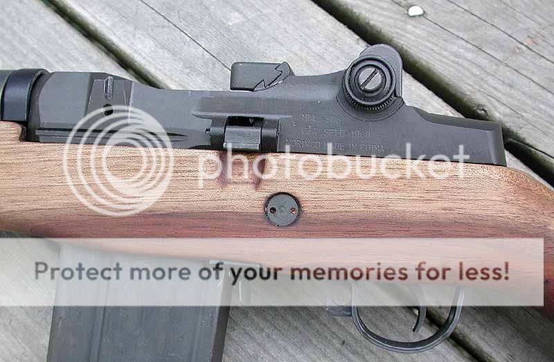

After a few hours' work:

Yes, I just started with 80 grit sandpaper then went to 120 and finished with 220 (it's all that I had!). I had really planned to paint the stock, although I was unsure how it would come out, and when I saw how quickly the old finish was coming off I decided to keep going. The sandpaper filled up quickly so I had to use a lot. It did not take too long to get most of the finish off...maybe a couple of hours? I had not heard of using oven cleaner before...I don't know it if would have made my work much easier since it was not a whole lot of work (and I'm the kind of guy who doesn't like work! :lol: ). With the sanding, the wood was nice and dry when I was finished--ready for the oiling. I used Minwax Tung Oil from Cdn Tire for the final finish...I'll confess to not knowing if it's best for rifle stocks or not. The way I figured it if it didn't work out I'd fire the stock in the garbage and get a new one!
