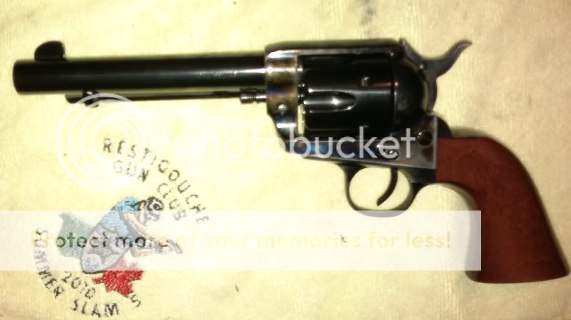

My new toy is in and wanted to share. Just picked it up today.
It's a Pietta 1973 (Peacemaker design) in .357.. 5.5" barrel. Went with this cal. so I can shoot .38 out of it as well, or maybe most of the time (especially bringing new shooter to the club) shoot the sweet but pricey Boom .357 once in a while... This will just be another toy for occassional shooting...

Sweet, I like the case-hardening. I've always had a 'thing' for old west style singles but Ionly have DA's. Something about the singles just screams HOLSTER! and with range rules the way they are, the only way I'd get pleasure from one is to joint an old west action competition. Still, can't wait to hear how it shoots.....pardner!
Thanks ya'll..

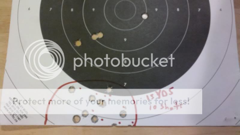

Above, are my first 10 shots (with Remington UMC 130 gr. 38special) using a shooting bag rest and I was in a odd leaning down position doing so and not so comfortable.. I don't think I was in good form.. but here it is.. will do another better test later.
there's 11 shots in there, the ones with red dot next to them are the 10, there on and few above was some extra fun shots I took after..
But as you can see it shoots very low at 15yrd.. I was aiming, for bullseye or slighty under.. hard to tell with black sights and black target (will use white with red dot on next run) I'm also shooting to the left, but that must be me... as others have said about these guns, they need front sight filed down.. will get to that when better tested and know for sure, it zero.
But I like the gun in general, seems to have a smooth rotation and nice clicking sound...
