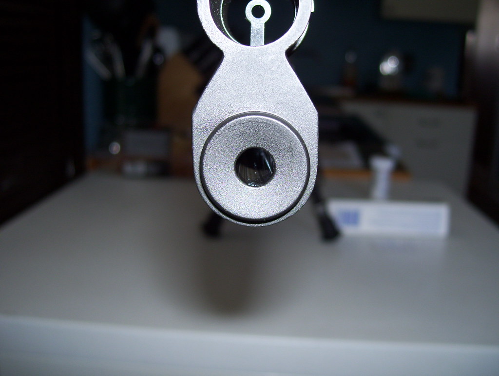

Here are some better photos taken outside. I have not shot her since refinishing, but I hope to get to the range tomorrow...
I tried to capture the bore. Not an easy task, but you can see the sharp rifling. Lots of life left!
