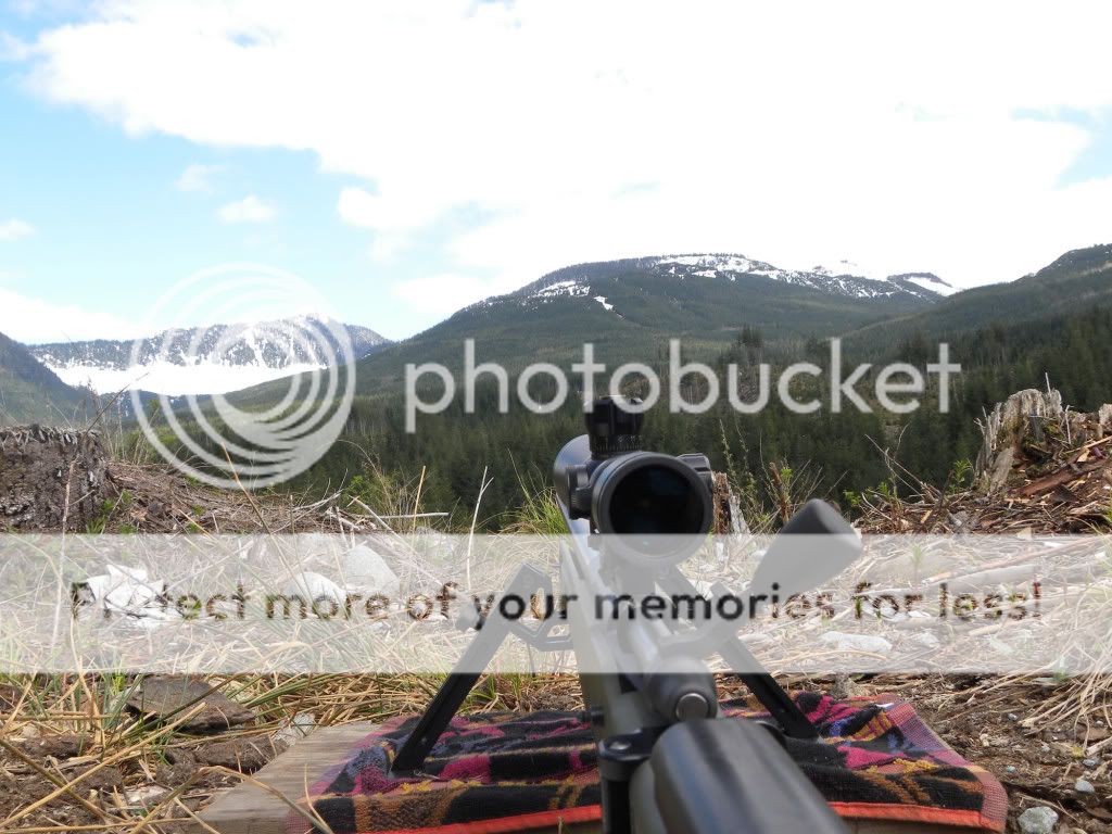

I didn't quite get 1 moa but I had an awesome day and learned a lot.
My range is less than ideal because I have no way of reading the wind. Between me and the target is a 150' deep valley so my only wind tape is at the firing line, and at around 880 yards. The target is at 900, it's the white dot to the left of my turret in the first pic. Its a 4x8 sheet of plywood with a 9" grid.
The second pic is my tool of choice. :D I just got my new pod, today was the first day using it and I'm really happy with it. Rock solid and easy to adjust one handed. Great design Jerry, thanks again.
And finally, the target. The bottom right was all me baby :p. The far left was all wind, but the 3 in the middle gave me a gun boner. It took a full 5 minutes to shoot this group, waiting on the wind. I didn't quite get it but I will. :cool: The .308 hole on the left is from my buddy, he shot two sub groups out of his factory 5R using 168 Amax over Varget, but he can tell his own story.;)
I'm using 90gr Berger VLD's over Varget.
sorry if the pics are too big, but I give up.. and the target pic is from my phone:redface:
