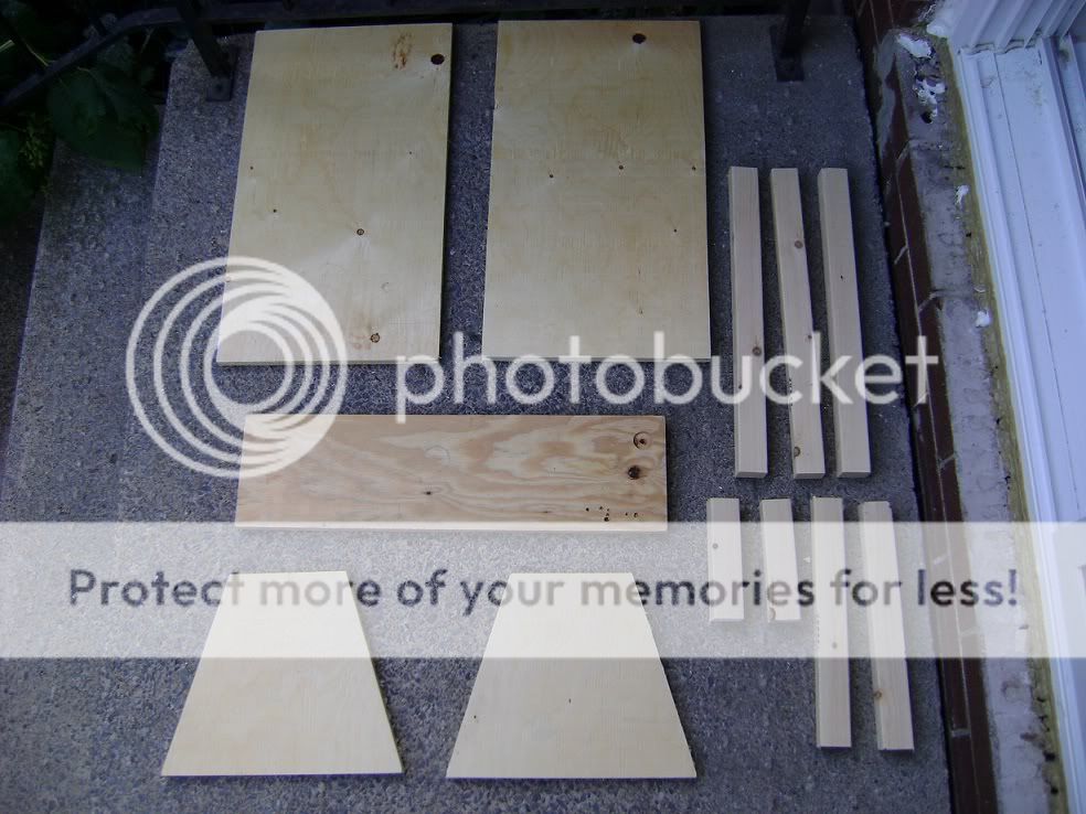

Anyway, the key features I was looking for is portability once again, good ergonomics and a base that's larger than the upper portion (where the press sits) so that this new reloading station would have a solid base that won't move during press operation. Here are the parts I cut out on the bench saw:
Note: the two largest pieces are for the base... I cut out two because I wanted the base to be extra thick (more weight = more stability). They were joined together by glue and 9 screws to form a 1" thick laminated wood base.

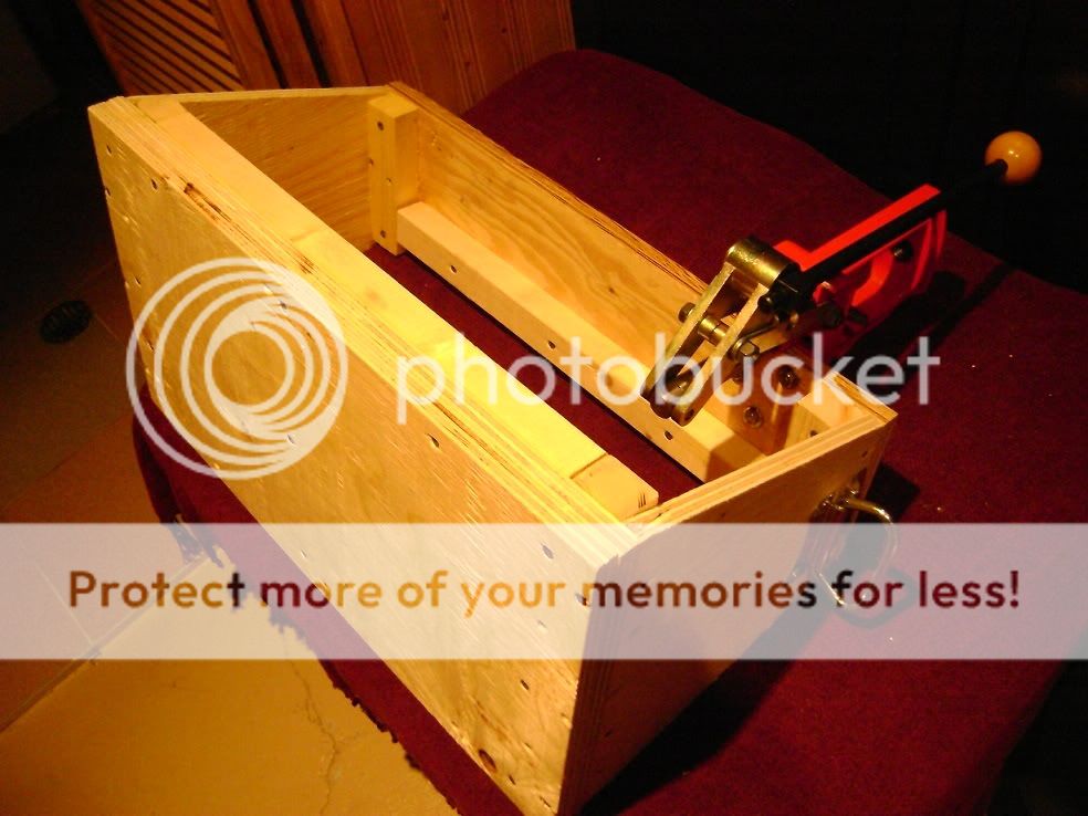

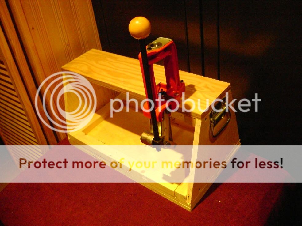

Now all I needed is some 1 1/2" screws (either for wood or gyprock, they'll both do), carpenter's glue for added solidity to the entire structure and some collapsible ammo crate-type handles that I'd screw in on both ends to make portability easier (optional, but good to have). Here is the final product after roughly an hour of work. Total cost ran me somewhere in the 10$ range, the handles being the most expensive part at $3.89 a piece at Home Depot).
Note: I am right handed, therefore the press sits all the way to the right for ergonomics and to give me better access to the bottom tray. For lefties, the opposite would be true.

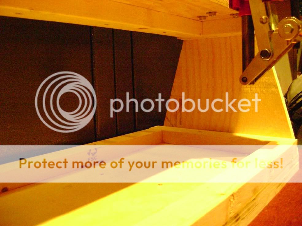

Note: Top is reinforced by a long piece of wood (1x1") underneath. That piece of wood had to be installed towards the rear to allow room for mounting the press screws.
And here are the dimensions. Please keep in mind that I did not AutoCad this thing to get the 'perfect' dimensions and that I used approximate dimensions that would work well for my press and wouldn't be too bulky (you can of course make it bigger, which will make the whole rig even more sturdy and solid).
Total length: 22 1/2"
Total height: 12"
Vertical (triangle-like) columns height: 10"
Base width: 12 1/2"
Top width: 6 1/8"
There you go... that's all you need to reproduce a copy of what I've made. The small pieces of 1x1" wood to make the tray sides and to reinforce the structure were cut to length in accordance to the other parts... so you can pretty much figure it out from there, as you cut out the biggest chunks first and put them together to get an idea.
Overall, I think it turned out pretty darn good for the money I've invested into it (and an hour of my time)... I loaded some 7.62 x 54R tonight to give it a good try and the entire platform sits rock solid on the living room table. Now I can watch the big screen AND load my bullets! Awesome!

Nice compromise. Good looking work as well. You don't mention what you're loading. It looks like it would be fine for pistol or small rifle cartridges, like the 223Rem. How stable is it with larger cartridges, like 30-06 or 338WinMag? I suspect, it would need to be clamped down to something, for the larger stuff. Mayber a few 25lb bags of shot on the base plate would do the trick.
Thanks for the feedback. ;) As for the 'bench', it's pretty stable as is. Like I said, I loaded some 7.62 x 54 Russian yesterday and the entire rig was solid on the living room table without any clamps... although clamping is also a possibility if I load something "extra large" or if the table-to-bench contact surface is slippery for some reason (varnished or aluminum table, etc). I do have some .577-450 Martini Henry to load soon, so I'll find out about how it handles the big (oversized) stuff - but I'm sure the rig can take it without much fuss. As they say, simplicity sometimes is genius. :D
The neat thing about it is that if you need some extra torque on the press, you can put your other hand on the top of the rig to give it some extra stability... and it happens to be just at the right height when it's sitting in front of you on any standard table (so you can constantly watch each shell going into the die without any extra effort). However, while I was loading 7.62 x 54R yesterday, I found I didn't need any extra help to keep it steady. In fact, I had my Lee Perfect Scale sitting on top the entire time (next to the press, in the left corner) and I was measuring powder with it for each shell. No movement whatsoever.
Today I stained the whole thing in 'cherrywood' and gave it a coat of varnish, then sanded it down to give it a bit of an 'antique' weathered/worn look... kind of like an old tool box after years of service. It's not common for me to say this about most of my projects, but this one had turned out much nicer than I expected. If I had seen something like this for sale at a reloading supplies or gun store, I wouldn't have minded paying a lot more for it... just because it it spot on for my needs.
I strongly recommend this design for anyone desiring portability and solidity. I think that the base that's twice as large as the top portion is the secret to its' stability, just as I predicted it would be. The prototype is approved!
