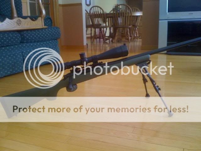

Hey guys this is my first precision rig, looking to get into the sport more seriously then in the past. Let me know what you think! Comments, concerns and advice is more then welcome!
Rem700 SPS 300 win mag with the following modifications
- Gaillard Stainless 24" 1:10 twist barrel
- Oversized recoil lug
- face of action trued
- oversized bolt knob installed
- complete barreled action finished with duracoat Tactical Black
- Harris bipod
- Burris Tactical Rings
- Sightron SIII6-24X50 LRMOA
- Picattany rail
Looking at getting a Mcmillian M40A-1 HTG stock and a bottom medal of some kind
Very nice you could try out f-class with that shooting f-open we need more open shooters in this area , let me know if you are interessted.
You might want to add some height to the comb. If you shoot with a good cheek weld as is, you'll be looking under the scope. The new stock will help a lot, get the adjustable cheek piece.
That looks like an early Sendero stock
