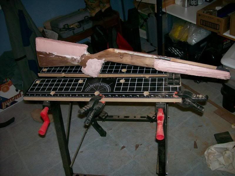

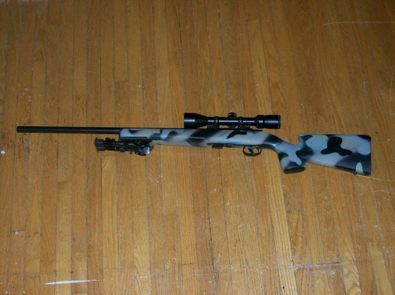

I ordered a stock from Numeriches when we could actually get them up here from the states. I paid $46 canadian dollars to get it here. Some bondo, epoxy and lots of sandpaper later, this is what I came up with.

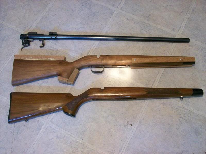

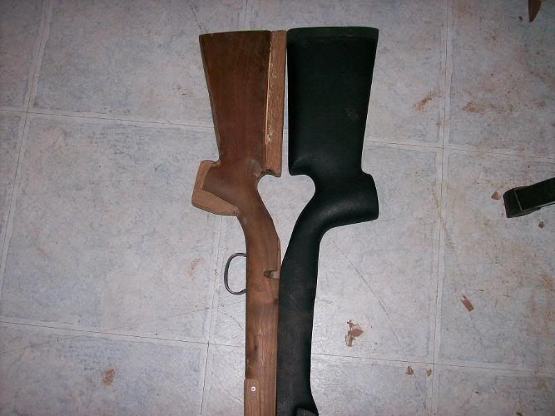

The original walnut with checkering and the wooden add ons that will be the bulk of the stock to build on.

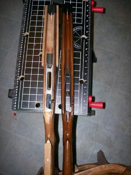

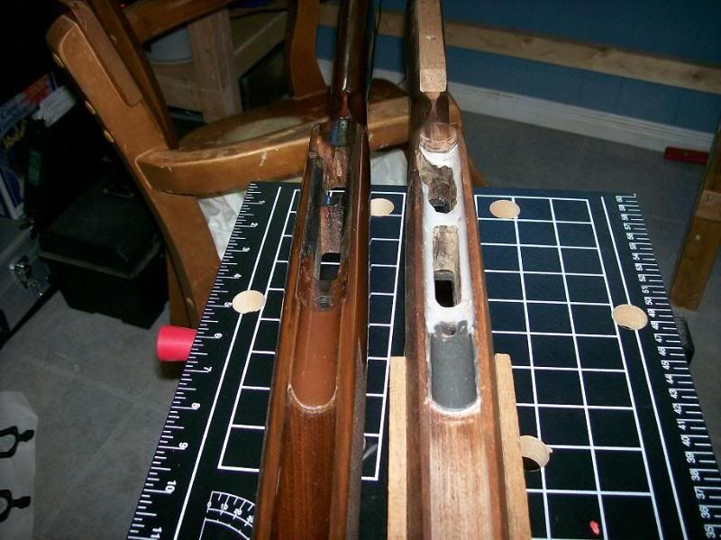

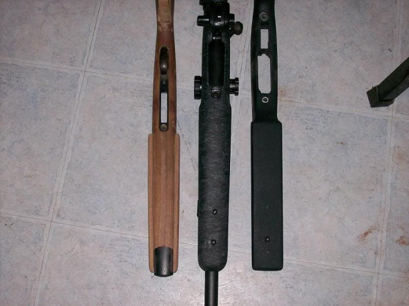

Side by side images of bedding.

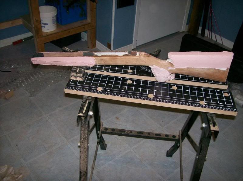

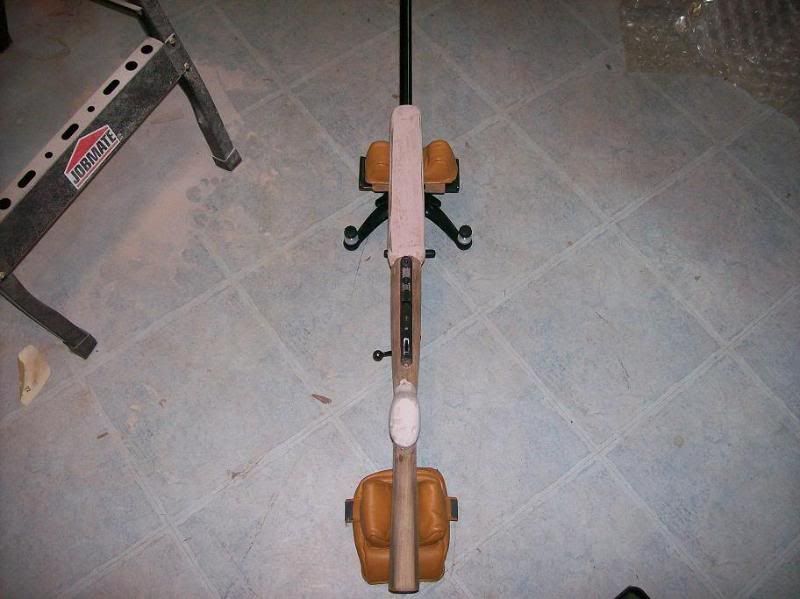

I wanted the butt end of the stock to look and feel like my Bell and Carleson Medalist stock and the front end to feel more like my HS precision. a bit of sanding later and this is where I was at.

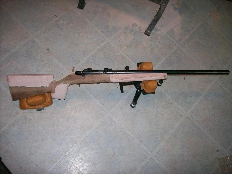

Then it was on to the bondo to contour and fill gaps.
Again with lots of sanding I started to achieve the look and feel I was after.

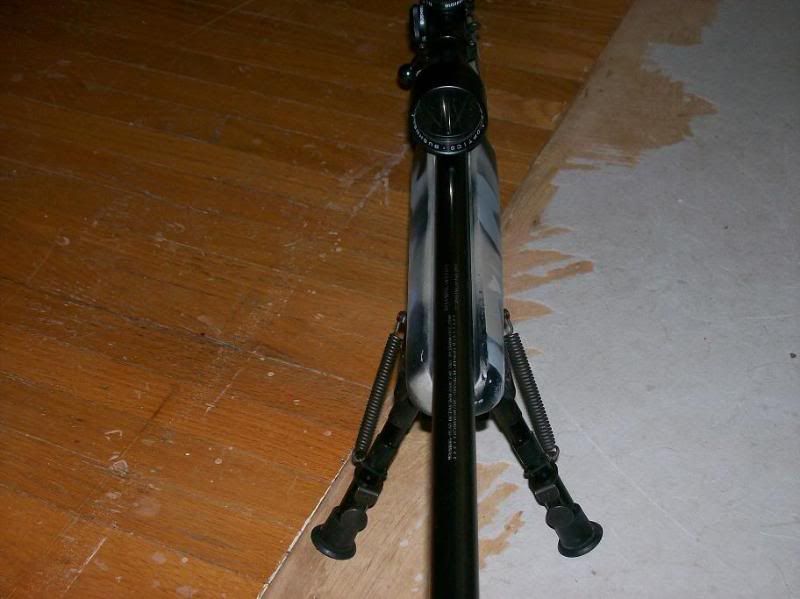

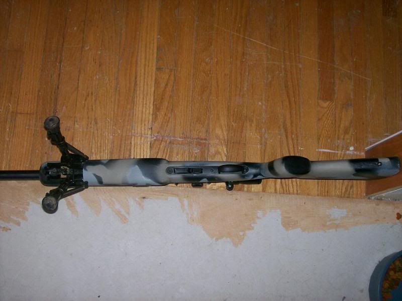

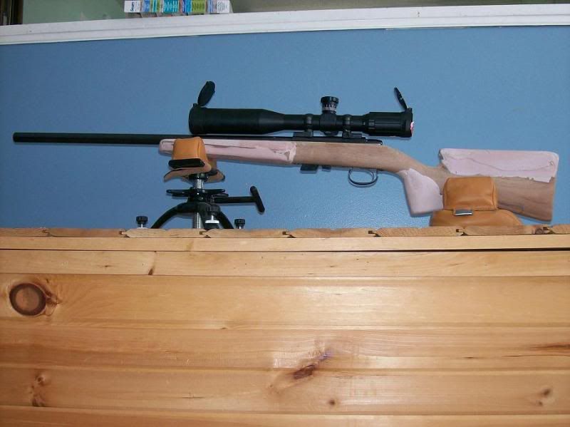

I needed a bit more beef in the front end and several months later playing in my spare time, I ended up with this..........

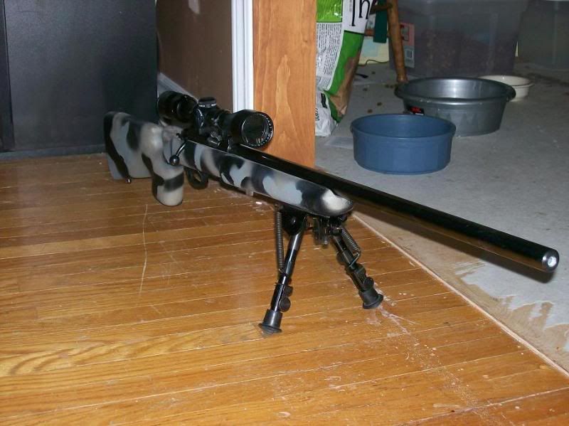

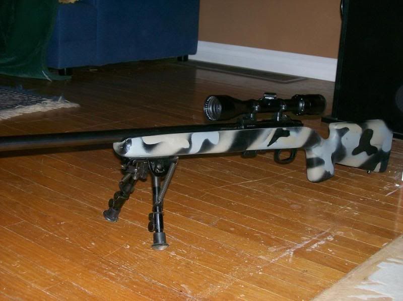

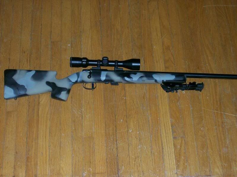

There are still a few minor imperfections. I can work these out as time permits. Im really happy with the outcome. Now if the snow would just melt I can get out and see how things came together.
