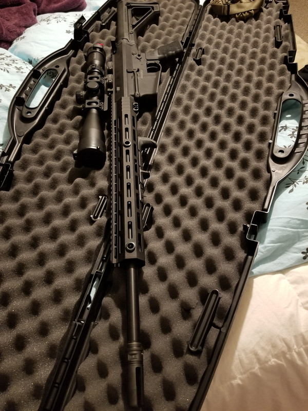

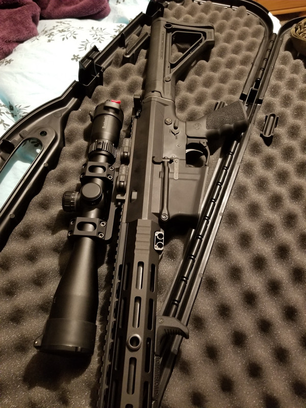

Finally got my reciever set in stock and did my build. Heres a list of parts.
Stag upper and lower combo with parts kit
Aero 308 buffer tube kit with spring and buffer
CMT mod 2 Mlok handguard
Ballistic Advantage 20 inch 308 barrel
Lantac gas tube
CMT gas block
Surefire flash hider
Magpul fixed carbine stock
Magpul Mlok handstop kit
Stag BCG
ADM recon mount
Bushnell engage 2.5-10x44 optic.
Gun shoots very soft and the BA barrel is fairly accurate, shooting about a quarter inch at 50 meters(indoor range). So far its been very reliable and went together with no issues. Ill stretch its legs tomorrow at the outdoor range. The target i posted is the first 3 shot group after zeroing the optic. 2 stacked right on top of eachother then the other was up top.
Sorry about the crappy photos. Ill take more when im back home.
Did you measure it? It’s supposed to be 12” on an AR-15. Aren’t .308 ARs receivers longer behind the trigger?
