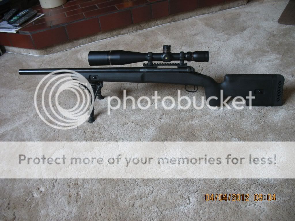

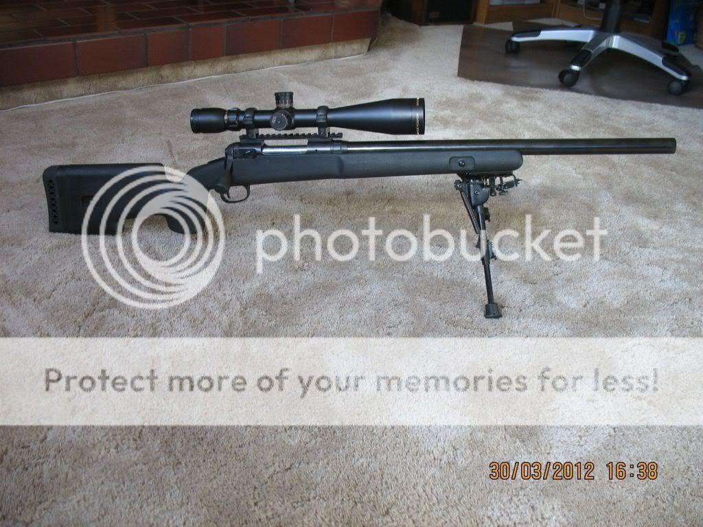

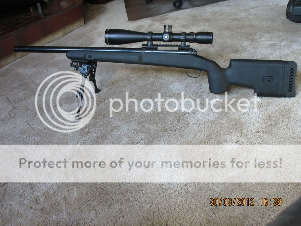

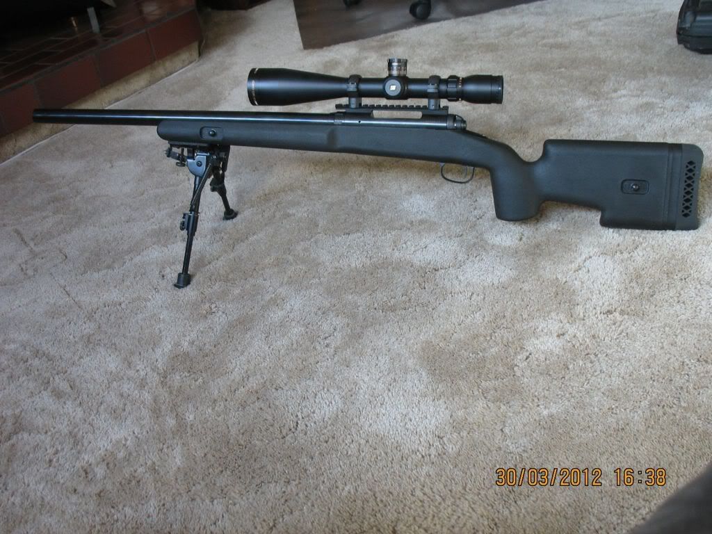

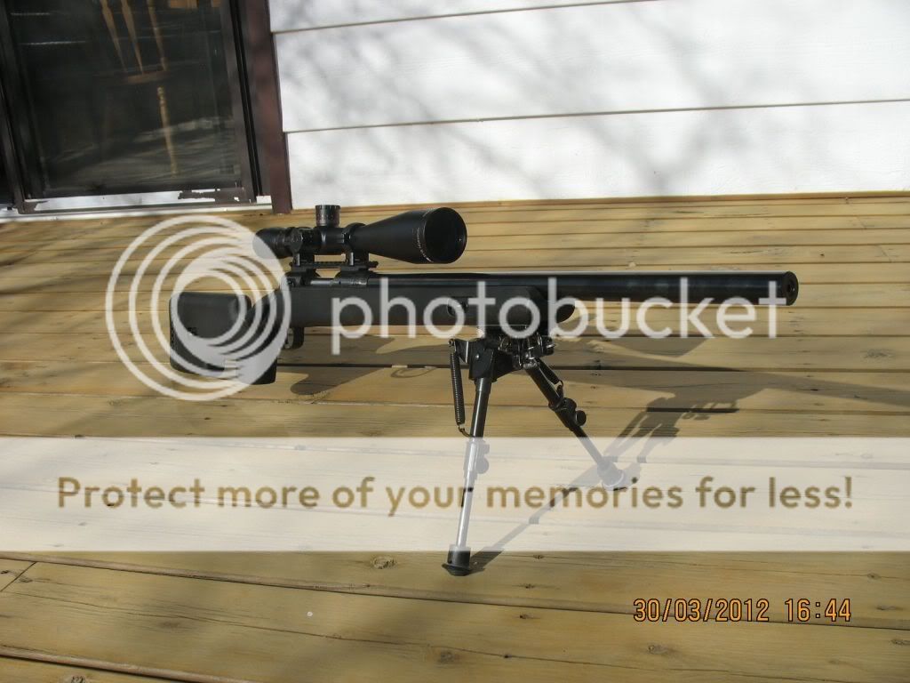

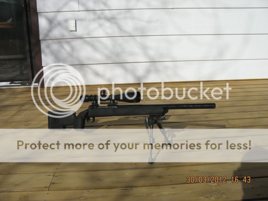

As the title says, it is not a 'build' as some folks here take issue with that...so it is a re arrangement of items LOL
Sorry guys but I don't know how to attach pics..so hopefully you can see them by following the links below.
Rifle was a .223 Stevens. With the help of Mystic Precision the following was changed
1) McGowen 1 in 8 twist heavy bull 22" in .223 prefit
2) Timney trigger
3) EGW 20 MOA base
4) EGW tactical bolt knob
5) Choate Tactical Stock - bedded
6) Bolt timing
7) Burris Sig Zee Rings
I topped it off with a Sightron III 6-24x50 LRMOA from Bowyers Guns in Maple Creek, Sk. Weight with bipod is 14.9 lbs
Hope to get to the range soon, but wanted to credit everyone for their help now!
http://i179.photobucket.com/albums/w305/bjboomer/IMG_4575.jpg
http://i179.photobucket.com/albums/w305/bjboomer/IMG_4571.jpg
http://i179.photobucket.com/albums/w305/bjboomer/IMG_4570.jpg

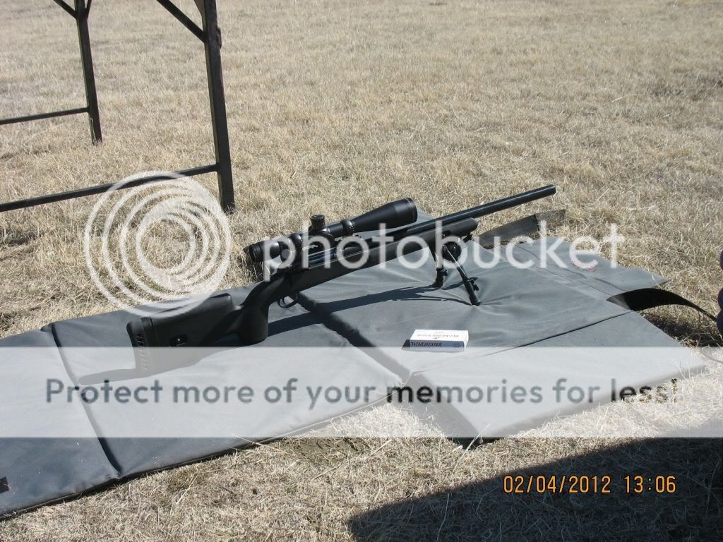

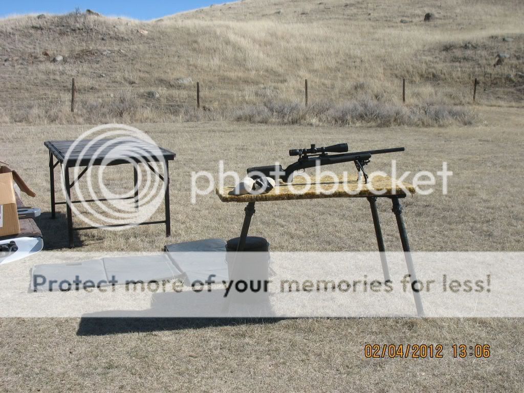

OK here is a quick range report. All I had for ammo was factory Winchester 55gr FMJ. After my break in procedure, I set up targets at 100yds and tried my best LOL. I know my bench tech is not the best so I experimented a bit. I tried the bench using Harris swivel bipod and then off bags, soft hold, firm hold, and just two fingers on the trigger type hold. Nothing would get much under a 1" group. Thats OK, because I need the once fired brass for future reloading. The good news, even with groups that were not stellar, I managed to hit all our gongs ranging from 200 to 650 usually on the first try. I had made up a drop table using 3100 as initial velocity. The Sightron III 6-24x50LRMOA worked flawlessly. I was a bit concerned about using high Burris Zee rings, but it seemed to be OK.
The Choate stock fit fine off the bench. I like the older Sako rifles with the palm swell in the pistol grip. Like others have said, the Choate is quite thick in that area but I loved and never noticed anything awkward. I even tried off handing a few and managed to hit the 200yd a few times, but this rifle and stock combo is just under 14lbs so it is not light; but was very comfortable off hand.
Although the pics show the rifle on my prone shooting mat, I did not use it. I tried. Our range has a rise to it. About 10' at 100yd and the rest are higher the further you go. Everytime I got down behind the gun I just could not get comfy. If I did, it seems my proper eye spacing to scope was not correct and all I saw was black. If I squirmed around to get it right, then I just was not at all comfy, and my neck was really strained. Perhaps in the future I will play around with the scope and move it forward & backward and try prone again. Maybe it has nothing to do with that and I am trying to use a bench rest type stock in a position it was not made for? Help me out here folks! I don't think that is correct, because it is a tactical type stock and it even has the studs mounted on the sides to attach carrying straps, so it should be usable in the prone position.
The only complaint about the Choate stock is very minor. The rear swivel studs just mentioned go across the stock....and they swivel....and they rattle. Like I said, not a biggie but you can hear those things rattle occasionally when handling the gun. An annoyance really, since I have no intention of crawling around or hunting with it, I may just remove them (if I can) or use a spot of silicone etc to keep them from turning/rattling.
So all in all the rifle/barrel/stock and scope combo work good. I am pleased. BUT, I will reserve final judgement until I can get some reloads working. 1/2 MOA should be easy to attain and I would be happy with that. Anything better will require the shooter to be on his game!
I was all by myself so nobody to take pics for me so can only show the bench and mat.

Looks to me like you need some lower rings. I have an extremely simmilar setup and run TPS Super Low Rings. With the 50mm bell I have about 2-3mm clearance to the barrel. They are advertised at 0.820" height. Another solution is an adjustable check rest like a tac pro.
Otherwise I would change nothing in your setup. Looks like it has big potential.
Post some target pics already! :D
I thought about lower rings too, but my advice from Mystic Precision was that these were the ones I needed. I am sure he has waaay more experience than I in this regard. I did attach a photo with sunshade on to show clearance.
