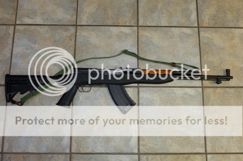

Russian 1951 tula non chrome lined. Sights stay zero'd and ive put around 300 bullets down range. I get about 1-2" groups of five at 50 yards.
Magazine fit fine in the tapco stock, but for them to click into the sks magwell, i had to shave the front of the mags similar to what this user posted. just jam them in, take a look where there are scuffs on the mag and file away til it fits.

I posted a thread a few months ago here. No issues to this day, I really like the rail.

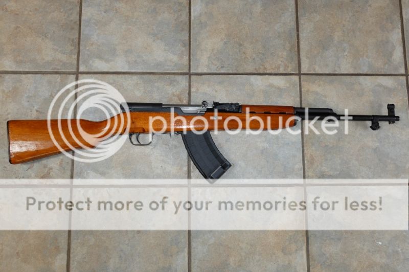

I got tired of fiddling with that Russkie, but I found this Type 56 on consignment at Mom & Pop's:
I now have two TAPCO mags and they BOTH fit right into this Chinee without any trimming or other mods--out of the box and >CLACK!<
It came with a blade bayo affixed, but I removed it before I even took the first new baby pics.
Here's what it looks like now:
I have GOT to change that handguard/gas tube, but I'm not about to attempt that de-pinning job in order to reuse the factory tube at the expense of ruining the original handguard. The ready-made sets being offerred now are either too expensive or don't work properly (suggestions welcomed) so Plan A is to find a take-off from an old SKS and do some cosmetics on it. That way I'll save both sets in their undamaged state and be able to return the guns to 'original' later on. But I haven't found one yet...
We haven't had a chance to get out to the range, but I expect this NORINCO to be a fair shooter--the bore looks shiny and the rest of it looks nearly new (as in "unissued", or "hardly ever used"--not "refurbed").

I got a spare gas tube i believe from Marstar, or possibly Lever Arms, and sanded it down and sprayed it with a can of truck bedliner from walmart, it matches the finish of the Tapco stock pretty well.
For a bit more snug of a fit, I put a magpul milspec stock on mine with a 0.5" cheek riser.
That looks sweet did you paint it by hand?
