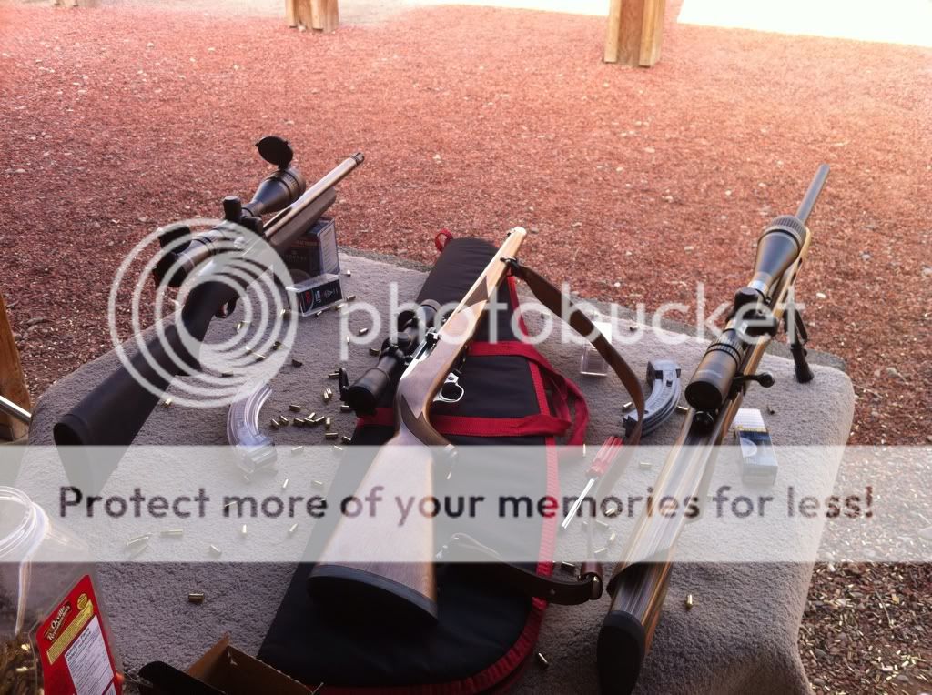

Ok so I made it out to the range yesterday, took the savage .17 Hmr out too for its second outing.
What a great time it was. When i first started sighting in the "new" 10/22 it was cycling great. for about 10 magazines i was in heaven, as its never cycled 100 %, usually 1 round per mag would either fail to feed or eject.
After the first 100 or so rounds its like every other shot was either failing to feed or eject again. just when i was starting to get frustrated i remembered my gun scrubber and boresnake for my .17 where in my "tackle box", gave a few squirts down the barrel ran the bore snake through (it was a little loose) a couple times. and it cycled about another 200 rounds flawlessly.
I only had federal ammunition to try out as i usually have good luck with it, it was ok for accuracy, but i feel i could get a little better. The fact that i havent shot all winter showed me that i need some more practice sessions before getting the gophers this summer.
Here are a few pics of the groups i was getting at 60 yards, i was shooting a little faster and not REALLY taking my time, more or less just getting a feel for the rifle again. But as you see from the first pic i also forgot my sandbags, so i was using a bulk ammo box as a rest. lol
And this one is a group that was shot by my friends 13 year old son at 100 yards (WITH my rifle) after we figured out where to hold the mil dots. the 3 shots inside the diamond are a legitimate group from this young guy! i was blown away!
ALL IN ALL... Definitely recommend DLASK barrels, and the hogue stock fits beautifully and is super comfortable for me!
