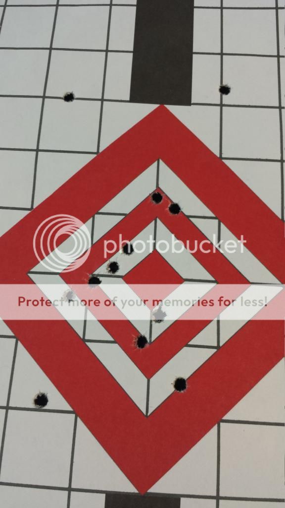

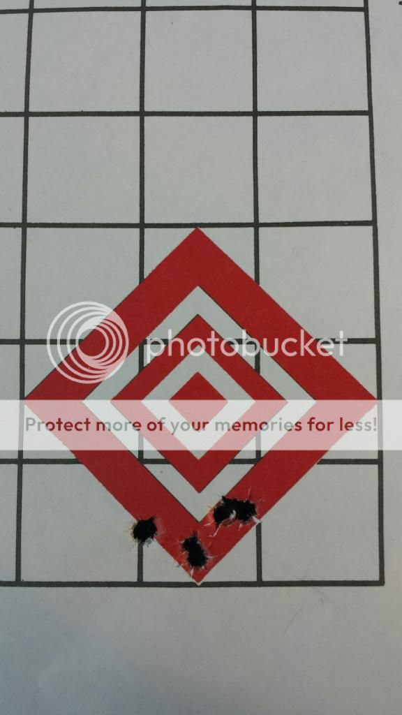

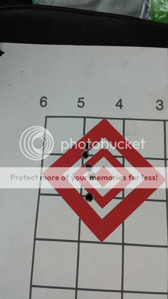

The 75gr Hornady BTHP match projectiles gave me my best groups. This was a hard gun to find a good load for, it is very sensitive to small changes in charge weight. Using the 75gr Hornady as an example, 24.7grs of varget produced 1.5-2 MOA consitently, but there was always vertical stringing, where jumping to 25gr gave nice and sometimes almost MOA groups. Here are a few 100 yard targets, all shot the same day at 6x mag.
10 rounds Norinco 55gr FMJ (Top two holes were already in the target)
5 rounds 75gr Hornady match with 24.7gr Varget
5 rounds 75gr Hornady match with 25gr Varget
