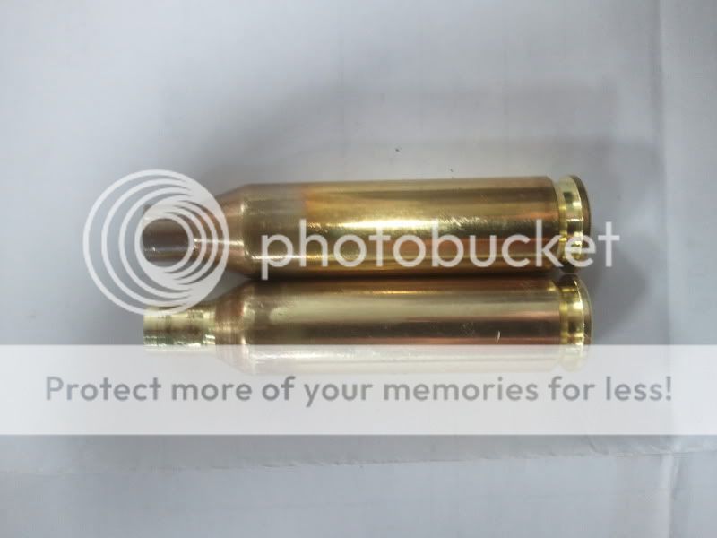

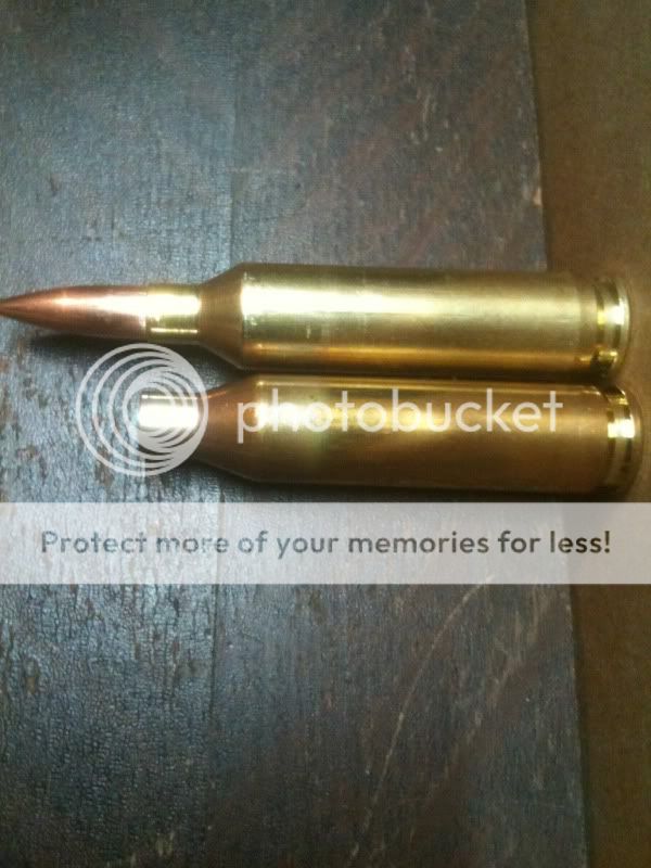

His Middlestead next to a .243 Win:
My Middlestead next to a .243 Win:

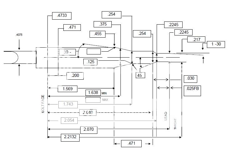

Reamer used on his Middlestead:
What I believe is the reamer used on mine:
