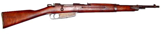

WWI M91 Carcano in 6.5x52 made by TERNI, Italy , cut down barrel and missing the rear sight elevations arm (can't call it a ladder). Typical post WWI / WWII stock repair.
too bad cut down as these have progressive rifling. Is the bolt handle bent down? BTW the date of manufacture should be on the hex portion of the barrel.

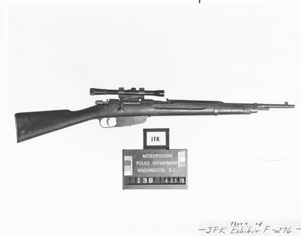

No that was a M38 in 6.5x52, like this one.
This is the JFK Carcano used by L H Oswald with a crappy scope on it.
