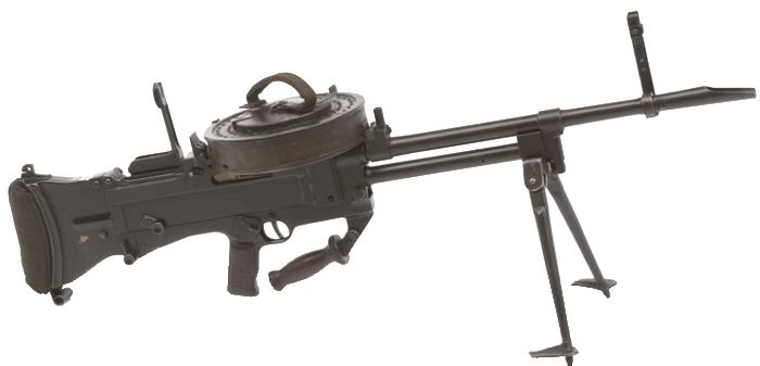

As far as I can determine this fits on top of a Lewis gun in place of the pan magazine. Which makes it rather interesting as I was not aware that the Lewis was much used in WW2. I am guessing that it must have been used as part of the British Commonwealth Training program for training air gunners. I am not sure what kind of aircraft would have been used to mount such a thing.
For Vickers K gun? There is a front sight base for the K gun which sticks up a bit directly in front of the magazine. The camera lens assembly would have to be higher than this base.
In addition this would be a training gun camera for obvious rrasons.
ground use conversion just to show the location of the front sight bases.
