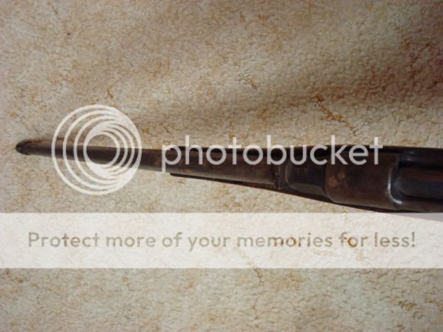

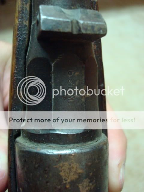

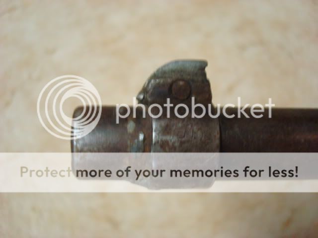

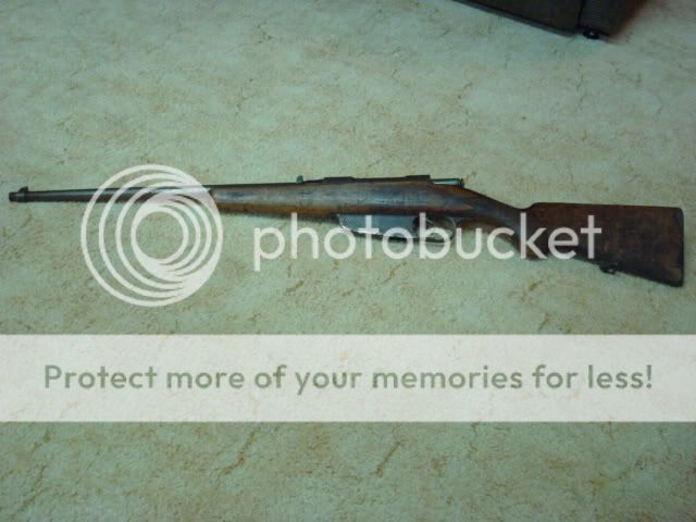

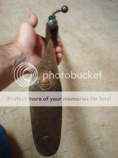

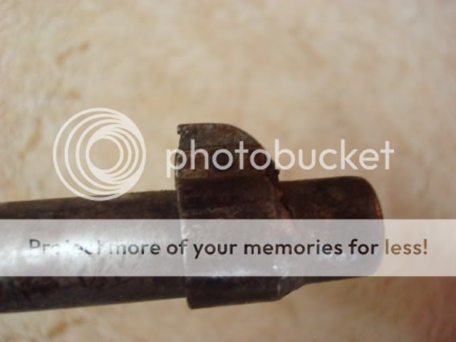

The only marks I can find on this rifle are "6.5mm" on top of the barrel and a small star behind the bolt. It takes 6.5 Mann Shoen and is not in good shape. Loads through the top from stripper clips, which fall out a hole in the bottom of the magazine after the last round (I'm told). Any other info on this old timer?
I have the same rifle, welded front sight and all, Its a Carcano, And a rough one at that, Its probably worth about 20$ Shoots 6.5x52, Even my grooving on the handle are the same. Mine has an extra wooden peice bubba's on, i'll dig up a pic, If you would like to peice it out let me know

Looks like an Eaton's Carcano to me. The fixed rear sight and double trigger were standard on these. Your rifle is missing the rear trigger.
A CGN member who attended an Gun Auction with me last week bought one in better shape than yours. I think he paid $30 for it. It had the two triggers.
CAUTION --- SOME OF THESE WERE RECHAMBERED FOR 6.5 MANNLICHER SCHOENER CARTRIDGE BECAUSE C.I.L. WAS MAKING IT AT THE TIME.
Many people detract the Carcano. Some of the long barreled rifles were made with gain twist rifling, and were very accurate. Unfortunately, when cut to sporter length, the gain twist was lost, and accuracy suffered. The Italian Military shooting team once used the Carcano to kick the Americans butt and outshoot the Garands and M-14s.
With the shape your rifle looks in, I would not fire it.

Thanks for the help guys. It IS chambered for 6.5 Mann Schoen, for sure. And I wouldn't fire it under any circumstances, I just wondered what it was, with no markings and all. The owner thought it was Austrian military surplus due to the round it is chambered for. But the Eaton's route makes sense.
Definitely a Cooey Carcano or Eatons' Carcano: same beast entirely.
They were surplus Italian Model 1891 long rifles from the Great War which Cooey modded considerably. The barrel itself uses the original Italian chamber, with a new section threaded on ahead of that. Sounds insane but it works fine just so long as the correct ammo is used and no flaming IDIOT takes out the securing screw and gives it to his cat to play with. The Cooey barrel is considerably heavier than the original tube and the rifling is very different. It is also constant-twist.
Carcano actions are often dismissed as weak. The fact is that they are extremely strong for the amount of material in them. They are very solid and an extremely accurate rifle can be built around a spare Carcano action, should you have such lying around. The bolt is a modded Mauser type with the unique Carcano safety which locks the action solid AND takes compression off the mainspring at the same time. They feed through a special 6-round Mannlicher clip which can be inserted either-side-up. The magazine slot in the bottom is very narrow and the left rail is very solid: all the basis points for a very accurate rifle.
ALL Carcano barrels were gain-twist except the Model 1941 and, of course, the Canadian-barreled Cooey variant. The Cooeys were fitted with a nice set of double set-triggers which most people seem to have ripped off about an hour after they got the rifles home. Too bad; they can shoot very well.
There were 'issues' with the Cooey variant and reports of injuries and even a death, mostly because the correct ammo was not available. Dominion made a special run of the right ammo about 1930 but by that time it was too late. Eaton's called in the remaining Cooey Carcanos, but a few specimens did manage to escape. Yours is one. The special ammo was sold in pink boxes of 20 rounds and cartridges were headstamped only "R" at 12 o'clock,"6.5m/m" at 6 clock.

i have one of these rifles as well in about the same condition or abit better than the one shown. mine however has both triggers. Is the value the same?

i love those little cooey sporters, ive got three complete ones. one thing ive found is there seems to be alot of varying front sights on all of them.
the stocks get busted up badly too. if you look at the pistol grip you can follow one line of checkering and it wraps right around the rear of the grip. when eatons had the rifles cut down, a flat was cut on the bottom of the wrist and the pistol grip attached there. makes for a delicate assembly and often these are found cracked at the rear of the receiver and/or broke through right through the wrist of the stock.
other wood work included filling the cleaning rod hole and rear swivel area with peices that were left over from the bubba'd wood.
