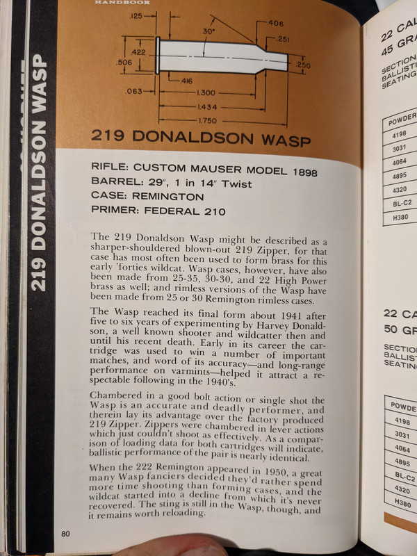

Bought a lot of ammo and this was included. Its a 30-30win parent case and a .22? Bullet. 3030 is on left, 25-35 in center.
I dont have the specs on hand but can get them in the morning

I agree that the 219 wasp is close. But the case seems too long in comparison to the shoulder on the 30-30.
Neck starts on the 30-30 is at 1.550. Where as the overall for the Wasp is 1.750.
Dug through my old books. There wasn't alot of 22 Cal's based on the 30-30. The 219 Zipper is longer yet at 1.875 but has a 12° shoulder vs the Wasps 30°.
The 225 Winchester, 218 Bee, .222 Remington Rim, .22 Remington Jet Magnum and the .22 high power. All have a smaller case diameter or way longer and have different tapers all together.
.22 Fawn is alot shorter at 1.300"
I'm thinking that it is a 219 Wasp. That obviously has been formed from 30-30 and needs to be fireformed.
I like this stuff.
Update
I suck at measuring and my 15$ digital calipers arent the best but
Coal 1.995
Bullet dia 221?
Case length 1.54 +/- a few thou
Neck size .240 +/- a few thou
